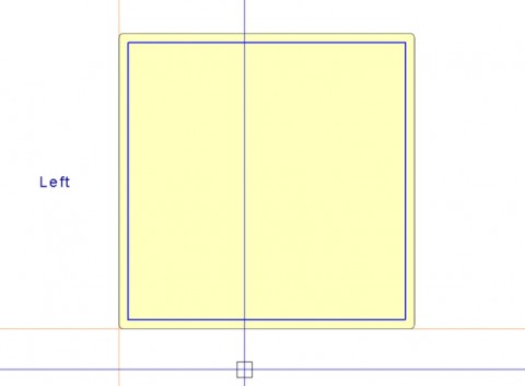

Josh,
Create your part with the outside radiuses and then create geometry .375" in from the edges (see my attached picture). Then create your profile edge from this geometry instead of the parts edges. I chose the lower left edge of the left vertical line and used a left hand comp. Seems to give me what you are looking for.

Re: Profile Modeler
Post by Josh Rayburn »
Thank you Scott, that's actually how I ultimately accomplished the task! I also realized when I did it this way, that I should fillet the inside of the rabbet also, because both the rabbet and the cut-through on the cabinet deck would use the same tool and would have the same radius. I would not have been able to do that if my original plan was successful - the radius offset to the inside would have resulted in a square. So in the end I'm happier with my product, but I wrote up the post thinking it might have been a bug in a simple operation. Thanks for the reply it's good to hear from you!
