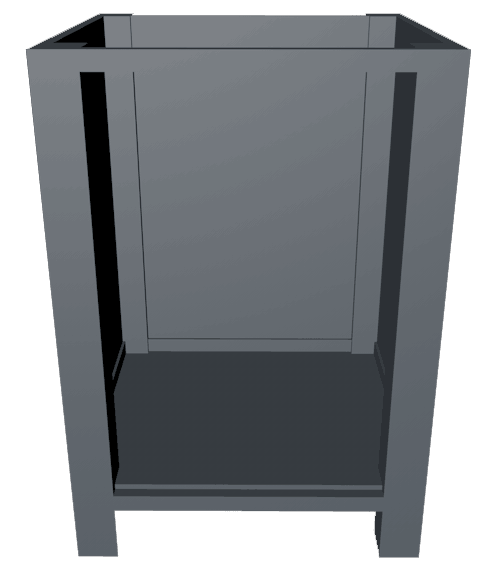

I have just spent a day reading up on this good software and can see how the seeding of a cab works on a standard unit but I need a different format seed cab please see the attached file.
So can any one help me out?
I have this unit in the following formats:
.c4d
.stl
.dxf
.3ds
and have:
maxon cinema 4d
google sketup pro 8
Need help making a seed cab!

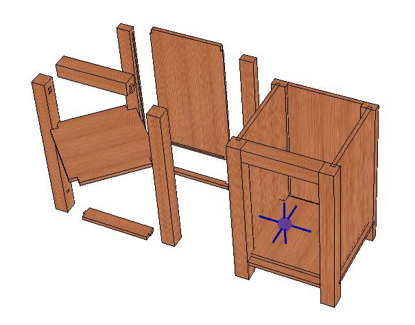

Hi Simon
Everyoney manufactures their cabinets in a slightly different way.
There are quite a few different ways that your unit could be done. Someone else might have one just like yours sitting in a folder ready to go.
Ecabs is very versatile but it will never do it just the way you want it.
So you have to work out the best way for your system.
The online tutorials are very good (I should watch them more often)
I have attached a quick assembly (made up from5 units) that looks a bit like yours.
It would need a lot of refining to make it usable.
The .esa file goes into the assemblies folder (not the cabinets folder)
Hope this is useful for you.

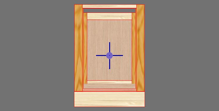

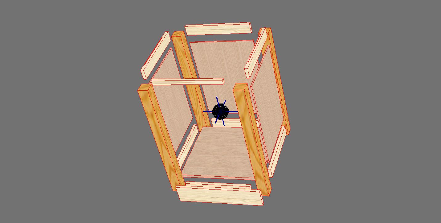

Hi
Sorry for not getting back sooner.
I have been working on this and have got it working as a resizeable cabinet.
What do you think of it (the different woods show the woods used to make it with this is a panted unit to the end user)?
If ant one want it at this stage it is only a seed cabinet all with butt Construction.
Simon
