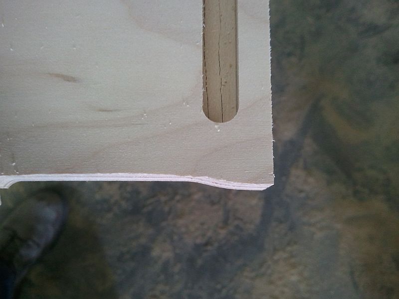

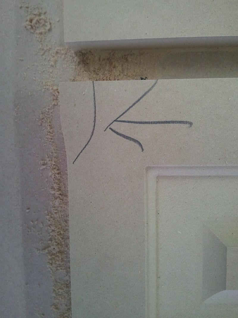

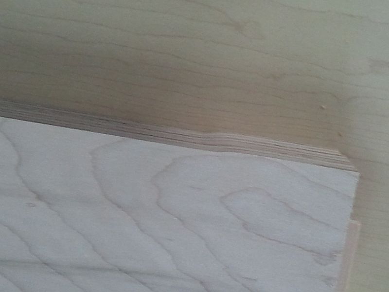

Cuts start at the correct place then move on the Y axis about 3/32 making the parts too small. It also raises the Z axis when it moves in leaving a 3/32" skin.
This happens on the top of the parts in viewing them from the machine fence.
This also happened on files written by PanelMetrix
Need Help as soon as possible.

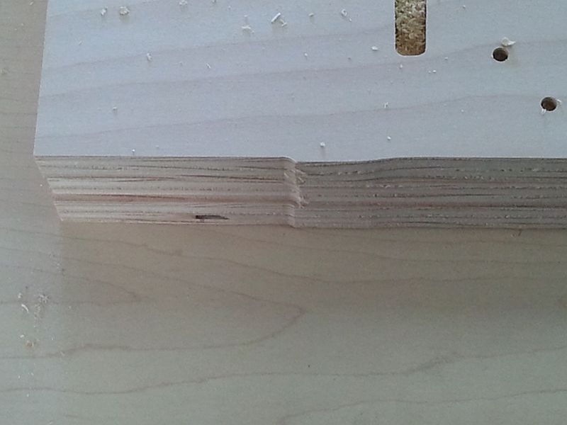

What is even stranger is that similar parts get the same bobble even on different sheets.
Here are three fixed shelves stacked and notice the cuts.
and three end panels

Thanks for all the trouble you went to. Late this afternoon we found that there was movement in the spindle. (I wasn't pulling hard enough) The plate behind the spindle had loose bolts in it. We cut a small job after getting it all back together and it looks ok. I still can't understand how the machine cut multiple parts with identical mis-cuts but I guess it could happen. (there were six decks, six tops and six fixed shelves that had identical cuts when stacked)
I hope this fixes a problem we had with bad tenons on flip operations and problems with our cut through.
Thanks Josh, Jason, Ryan and Scott for your help.
