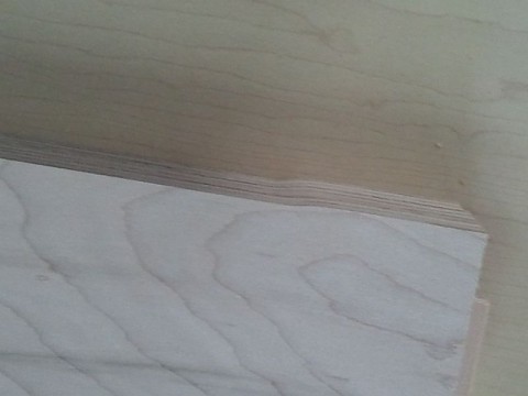

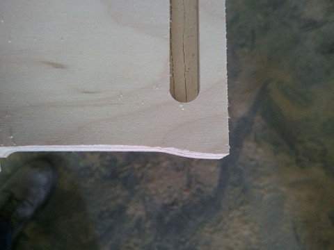

Cuts start at the correct place then move on the Y axis about 3/32 making the parts too small. It also raises the Z axis when it moves in leaving a 3/32" skin.
This happens on the top of the parts in viewing them from the machine fence.
This also happened on files written by PanelMetrix

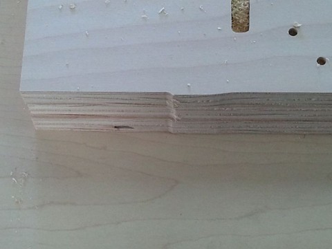

What is even stranger is that similar parts get the same bobble even on different sheets.
Here are three fixed shelves stacked and notice the cuts.

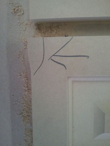

and three end panels
