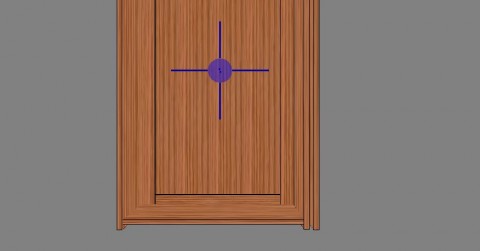

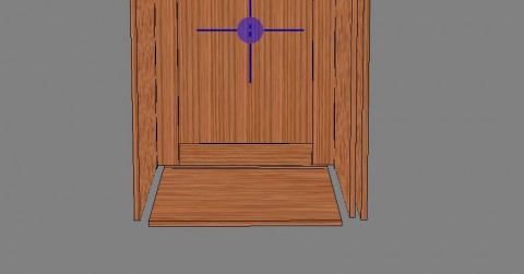

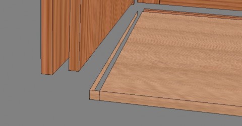

I have a problem/question with a construction method. Im trying to create an inner wall with a stretcher that reaches beyond the deck, but since you need to select two pieces for it to "stretch" the only way i could think to archieve this is to make the bottom joinery a fulldado with the settings of the thickness of the dado of what i needed, it seemed to work but it left behind a little material that i dont know why it doesnt dissapear if the dimentions are correct. You can see what im talking about on the images.
Is there another way to make this kind of construction or is this fine and i dont need to worry about the remaining material?

Try using a partition instead of a stretcher and let the deck dado into the end and the partition dado into the deck. It looks like you might have the dado depth for the stretcher too deep also.

Check the depth of the dado that you have set for the stretcher as I stated it looks like it might be too deep .

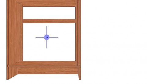

But its not a stretcher, i used a partition like you said and now it looks like this just like they wanted. So is there a way for a partition to lock it like the stretcher?

Sorry Pedro I miss understood The answer is no there is not a way to lock partitions.
