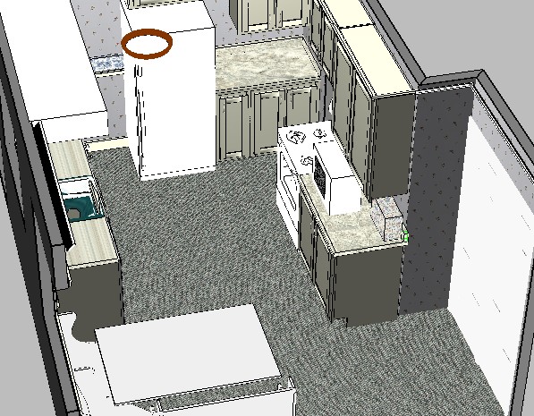

Ok I used the last method and finally got the result I wanted. Now I have a couple more problems. My board stock won't change to match the rest of the cabinet. Now my face frames are wrong. I've tried texture match, I closed the layout space, tried changing preferences and updating that, still can't get it to match.
I'm also having a problem creating a display cube for my sink counter top. I go into cabinet editor, open the cube, set the dimensions, set the image, click create cube. It comes up in the editor looking right, the minute I take it into the part editor and cut the hole and bring it back, the image has changed. I've tried doing a texture match (back in the layout room) to the outer counter tops, I've tried the render mode method of setting the image for the cube there, it still doesn't change to match the other counters????
I'm almost done with the rest of it, I just can't get these to cooperate.
George

Thanks a ton. I wrote it in my notes for future reference. Now to the sink counter. Isn't there any way to make it match? It looks like hell. Can I make the image smaller somehow? Why would it be right in the cabinet editor, but wrong once it returns from the part editor? I'm about to just mount that sink on a regular counter and let it stick through
To make a ceiling I just make a display cube the size of the room and put it up there. How do I adjust my lighting if I do that?

Georg you can cut the opening for the sink in a actual counter top by selecting it then right click on it Then under edit options select part editor. This will take the counter top to the part editor where you can cut the hole for the sink.

YES!!!!! Thanks Scott.
