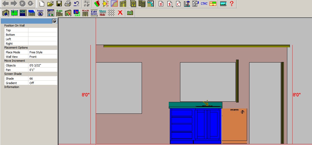

I accidentally (still not sure how) deleted one of my walls. Of course it had to be the one with all the doors and windows :fire: Now I made a new wall. I have associated all of the moldings to it but it is not showing up when I go to the elevation view. I have 2 sticks that are there but the rest of it, who knows where it is. :wall: I had it associated to 2 walls. The one wall I can see it, but can't put it where it belongs. However, while on that wall I moved it out in the room a little to be sure I didn't have it buried in the wall. Still nothing. There should be a chair rail and baseboard not showing up either. I have shut down the program and restarted it but that hasn't helped either.
Still trying to get the counter tops to match too. I've rebuilt that one (oops not there right now) over the dishwasher 5 different times and tried doing a texture match, still doesn't work. I've taken it into render mode and tried changing the material image from there, still won't match. This is a custom material image, but that shouldn't matter, it works on the other counters fine. If I try to create the entire counter out of a display cube; it stretches the image instead of it being tiled.:fire:

I was encountering similar issues. Try seeing if the item not showing up is already associated to 3 walls. If so you may have to disassociate 1 of the walls then re associate the wall you want to show up on. This is what worked for me. Don't know if 3 associations are the max to an item but it seems so??

I generally try to stick to a 2 wall if I can. I shut it off again only this time I said no to save the job. When I fired it back up there was the molding that had disappeared the first time. Talk about frustration. Now I've got molding on top of molding. Fortunately one is not painted so I can grab tht and delete it. Almost afraid to. :lol:
I've had a couple of issues with disappearing walls too. It is always the walls I have associated with something. I may be forgetting to click off the wall when I delete something, that would probably do it. :lol:

I have a stinking suspicion that Windows was doing a background update while I was trying to work. When I went into render mode, first a table set was missing. So I hit render again. This time all the darn cabinets were gone off the same wall.
