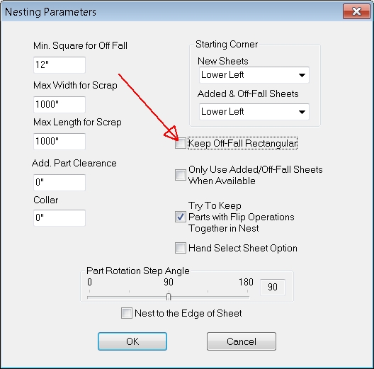

Re: Off Fall iregular?
Ian,
Do you have this box checked in your Nesting Parameters for the Settings Group your material is in?

Ian / Kerry,
Perhaps the issue is more with the selection regarding the handling of Off-Falls. You now have the option of Cut Full Perimeter of the Offall, just Save Only where the "raw" shape is saved or ignoring (None) them altogether. If the Full Perimeter is not selected, then... well you probably won't get your rectangular shapes.
Control Nesting - Off-Fall Settings
Just a thought...
