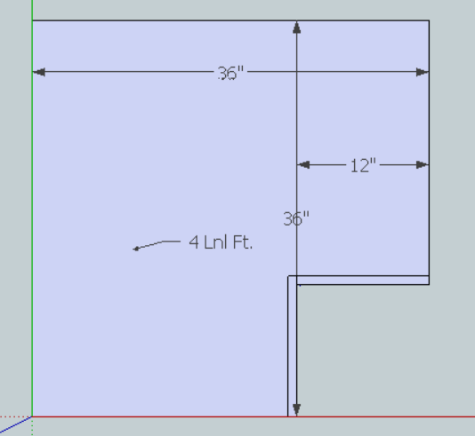

upon looking at this further even 36 x 24 is not the correct dimensions it should be 36 x 12. I say this because if you have a 36 inch corner cabinet that is 24 inches deep and 36 inches in both directions the total linear feet for that cabinet is 48 inches. See the screen shot below
