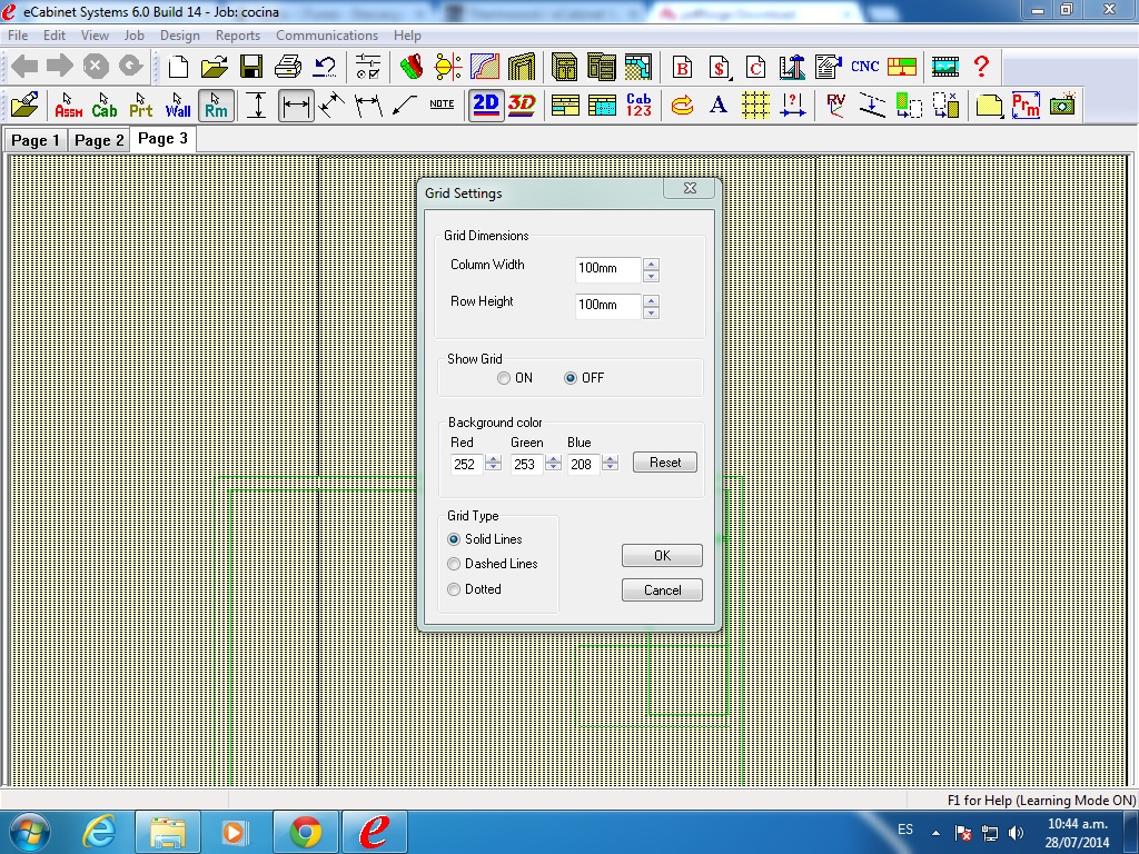

Hi,
I just changed to win 7. And I am getting the screeen full of dots in line drawing editor at any zoom level, and I have grid turned off and the dots don't go away.
screen full of dots in line drawing editor

Re: screen full of dots in line drawing editor
Cesar,
Ensure that you have the latest available graphics driver installed for you graphics card. Not through Windows, but rather from the card manufacturer's website.
Hi Scott,Scott G Vaal wrote:Cesar,
I have installed all the latest drivers for everything, and I still get the same dots.
However, if I check "Force Software Rendering" the dots disapear. What will that do? Will that affect performance?

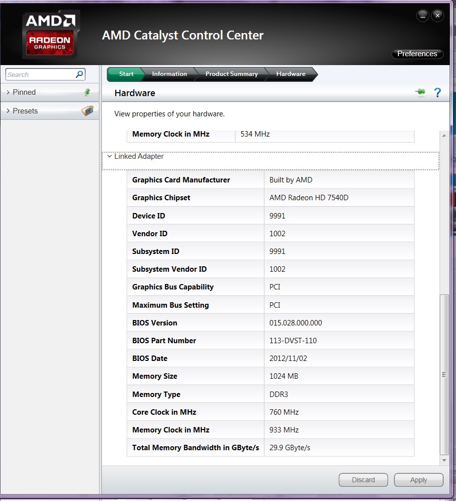

- Scott G Vaal
- Posts: 1740
Cesar,
Force software rendering tells eCabinet Systems to bypass your graphics card all together. With that said, it does seem that there is an issue with your card/driver. What card do you have (make, model)? It depends on your graphics card, but yes, there typically would be a reduction in performance when forcing software rendering.

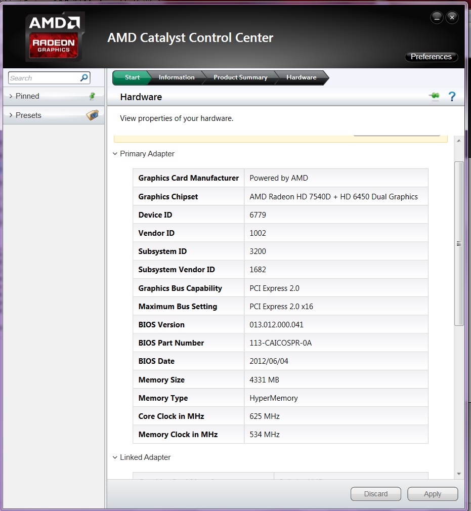

Sorry I didn´t see your reply before, any way, my system is:
AMD Radeon HD 7540D + HD 6450 Dual Graphics
Sistema operativo Microsoft Windows 7 Ultimate
Versión 6.1.7601 Service Pack 1 Compilación 7601
Descripción adicional del sistema operativo No disponible
Fabricante del sistema operativo Microsoft Corporation
Nombre del sistema PCDECESAR
Fabricante del sistema Gigabyte Technology Co., Ltd.
Modelo del sistema To be filled by O.E.M.
Tipo de sistema PC basado en x64
Procesador AMD A6-5400K APU with Radeon(tm) HD Graphics, 3600 Mhz, 1 procesadores principales, 2 procesadores lógicos
