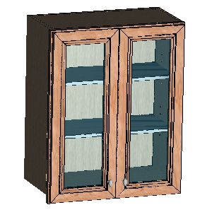

How do you create a material that looks like glass for glass shelves? I've been searching the forum and am unable to find what I need.

Try this
W2430 with glass shelf.jpg (20.08 KiB) Viewed 62631 times
W2430 with glass shelf.hsf
(410.02 KiB) Downloaded 2158 times

The procedures for creating glass shelves are detailed in the online video training series and in "The Nearly Complete Guide to eCabinet Systems".
Generally, you install a shelf of the appropriate thickness. Export it from the File menu. Open the Display Part Editor, and edit the "Shelf" file. You can change the color and make it transparent. Save this file, then insert it into the cabinet as a Display Part.
