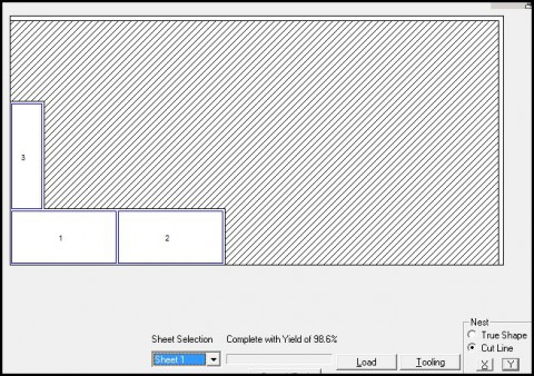

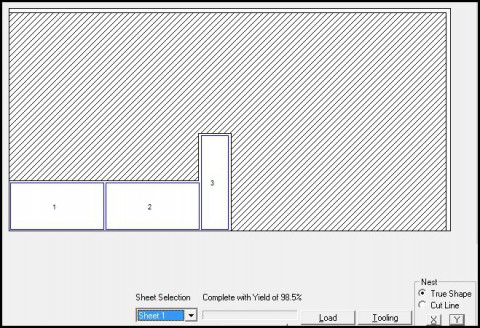

I'm glad to hear that you're going to try and have it added in the future Scott, but how do I proceed right now? I thought I could at least cut each cabinet individually and the SBL would nest the fronts appropriately, but as you can see below, it doesn't want to place the drawer front above the doors regardless of how I nest it. Aside from creating a sheet that is just a little wider than the cabinet and then nesting onto that (which I have yet to try), does anyone have any better ideas? That could take a lot of time to cut fronts for 38 cabinets.
