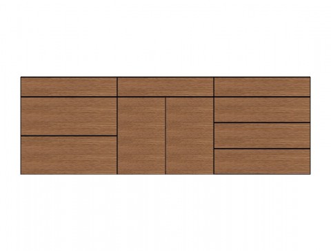

Thanks Brad for the response and PDF. I don't have, at the machine CNC experience, but obviously an experienced machine operator would undersatnd this better. In short though I understand the concept and that you say it can be done. I have attached a jpg as an example of the cabinets I am trying to apply this to.

Unfortunately, the combinations that you have illustrated in your image cannot be combined into one single grain matched entity. As noted in the PDF document, the "T" confirmation and similar layouts cannot be produced as it requires unmatched parting cuts with the outline tool. (And an 1/2" outline tool does not equate to a 1/8" gap.)
Perhaps your best bet would be to grain match large rectangles that represent the overall door/drawer area for each cabinet and then part each appropriately with a saw and an 1/8" blade.

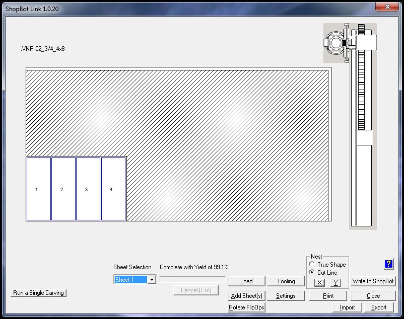

So, back in April when you told me about this Rick, I tried it and took a look at the nest diagrams and everything looked fine. So I bid the job as if I could sequence the fronts.
But now I'm actually trying to create and send a TWD file to my ShopBot link for cutting and it doesn't seem to give a darn what the EC nest diagram showed - the SBL is nesting them how it wants. How do I get the nest layout I desire from EC into the SBL for cutting?

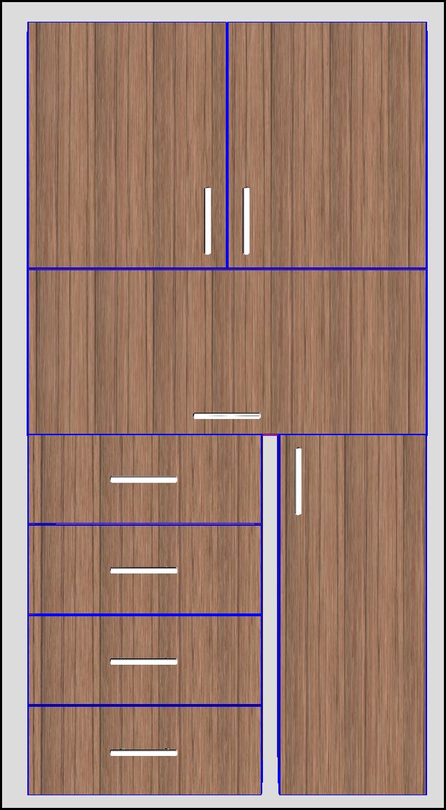

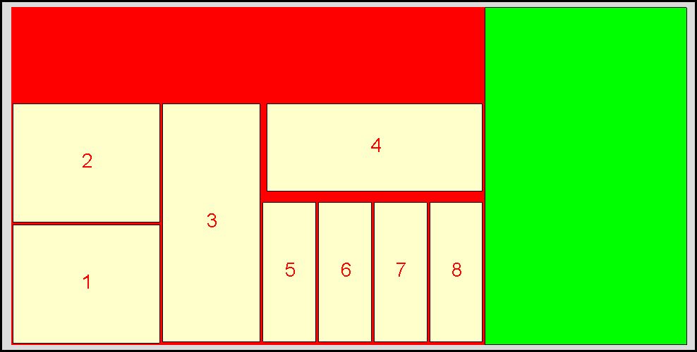

Actually, only some of the fronts appear in the SBL nest. Here's a few pics to show you what I'm seeing.
1) The 3 cabinets saved as an assembly in EC (with grouped parts/fronts). 2) The EC nest diagram correctly nests the fronts of the assembly. 3) But only 4 fronts are nested in the SBL. Any help would be appreciated, I'm supposed to start cutting tomorrow.
