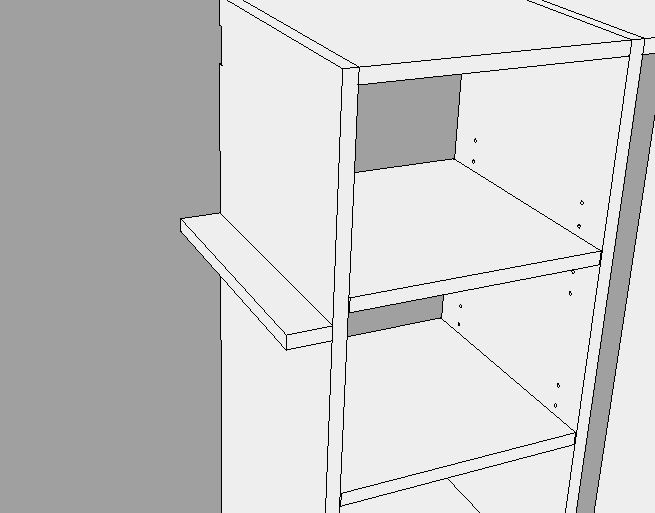

thanks for the explanation. I have tried adding an adjustable shelf to the outside of the cabinet and the joinery doesn't apply nor have I found a way to make the shelves come to the same level inside and out. see picture here: its too bad that you can't save individual furniture components as an assembly (example a left gable with shelves) and attach it to a cabinet and the construction would apply to both. It would save so much time when doing things like closet components with shared gables.
Alain
Alain

Re: joinery between 2 cabinets in an assembly
Alain,
If you want shelf pin holes on both sides just Check the Thru Holes box in the adjustable shelf Hole Settings.
