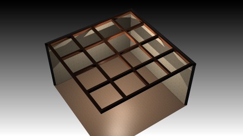

My question is....can I create a sloped ceiling with trays, coffures and beams in Ecabs and what tools in the software used to create the ceiling coffures. Thanks for any help with this.
Ted
Re: sloped ceiling with coffures and soffits
This coffered ceiling is just a single cabinet made from a material 4" Beams. You can put a back in if you want a wood look above the beams but it makes lighting the room harder.

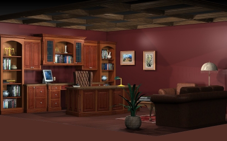

This is an old design of mine using this technique.
