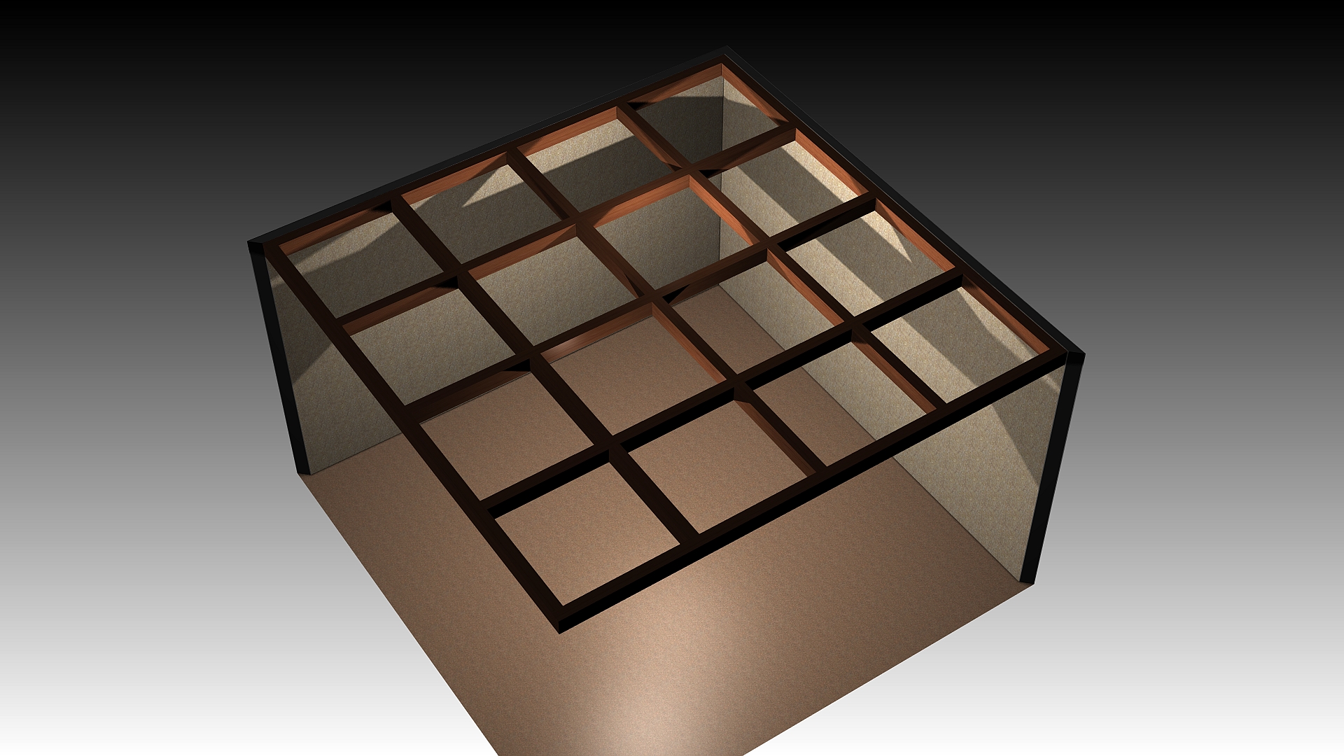

This coffered ceiling is just a single cabinet made from a material 4" Beams. You can put a back in if you want a wood look above the beams but it makes lighting the room harder.
This is an old design of mine using this technique.
