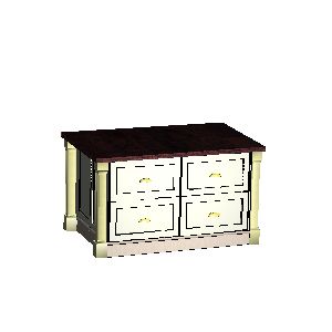

Are you working in the room layout or Cabinet editor?
Everyone has a different work method but for what I think you are trying to do I would start off in the cabinet editor.
In the cabinet editor you can make assemblies with many units, display panels, display objects and it locks them all together.
Then you just pull the assembly into the room layout.
I like the cabinet editor because it has the align to Zero function.
The picture is of an island that I put together in the CE, I believe it is simpler now to place it in a room.
Hope this helps

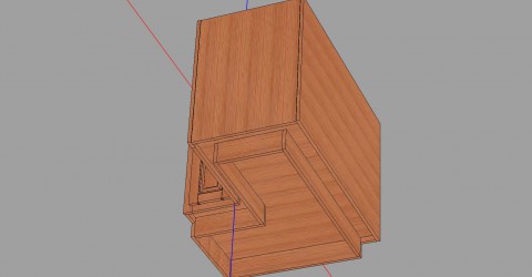

I thought I would take a stab at this.
The cabinet in the photo was made using the original back with the grain rotated 90 deg.
In construction settings I set the cabinet up as follows
In the corner settings I set the corner gap to 0” and checked mightier 90 deg. corner. This allowed the finished back to extend to the outside of the left back.
In the Back tab.
I set the construction for the left and right to butt.
I selected Back Flush for the right side
In Right end tab.
I set the bottom inset using the f(x) feature to be the Toe Kick height
In the toe kick tab. Under insets.
I set the right inset (the finished end in this case) to be the toe kick inset (3 ½” in this case) – the right end thickness. (3/4” in this case) This came up to be 2 ¾”. This gave me 3 ½“from the outside of my finished end for the finished end toe.
Click ok to keep all changes and exit construction settings

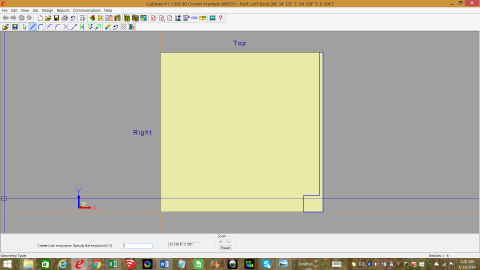

Then I took the left back into the part editor. Note that when the part is loaded in the part editor it says that the right of the part is actually on the left of the screen.
In the contour area I created edges and used the offset tool to create the geometry for a pocket that cut ¾” off of the right side (the side to the right of the screen) as well as the toe kick cut out. See The "Left back" Screen shot.
I then exited the contour mode and cut the pocket. Then returned to main keeping the changes.
To get the bottom of the finished back the same height off of the floor as the toe kick. I took it into the part editor and used the same procedure to cut the bottom off 3 ½” (the toe kick height) off of the bottom.

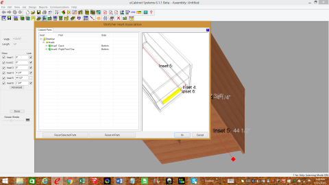

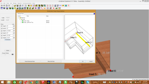

In the stretcher editor.
For the finished end toe. I created a stretcher/Sleeper by selecting the right back (the finished back in this case) and the right front toe. Then applied the insets and advanced settings as per the screen shot "finished end toe settings".
For the Back toe I created another stretcher/sleeper by selecting the left back and the left front toe. Then applied the insets and advanced settings as per the screen shot "back toe settings".
Hope this helps.
