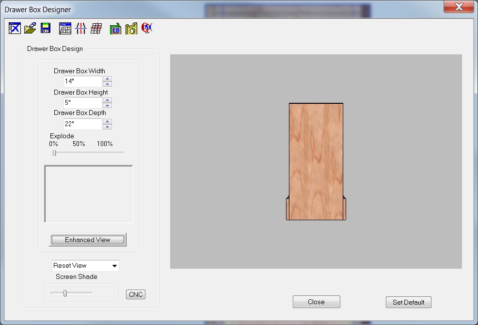

I have a drawer box that I made. In the settings I've specified that I want the grain orientation of the front and back to be up and down (rotate 90 degrees in settings). It is displayed properly in the dbx editor.
However, when I go to nest the cabinet the orientation of the dbx front and back are changed. Not sure what's going on here. Having tried rebuilding the drawer several times and I keep coming up with orientation correct in dbx editor but not in nesting.
I've attached pictures along with the dbx and cabinet file.

Incorrect orientation in nesting
Correct orientation in dbx editor

Hi Donald, I changed the grain direction from 90 to 0 and it nested fine
