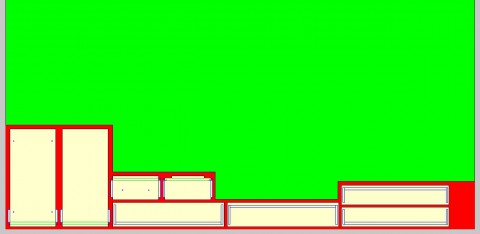

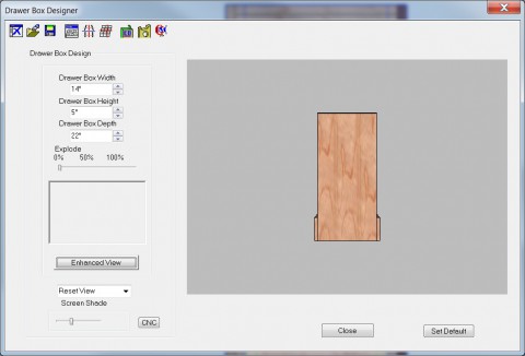

I have a drawer box that I made. In the settings I've specified that I want the grain orientation of the front and back to be up and down (rotate 90 degrees in settings). It is displayed properly in the dbx editor.

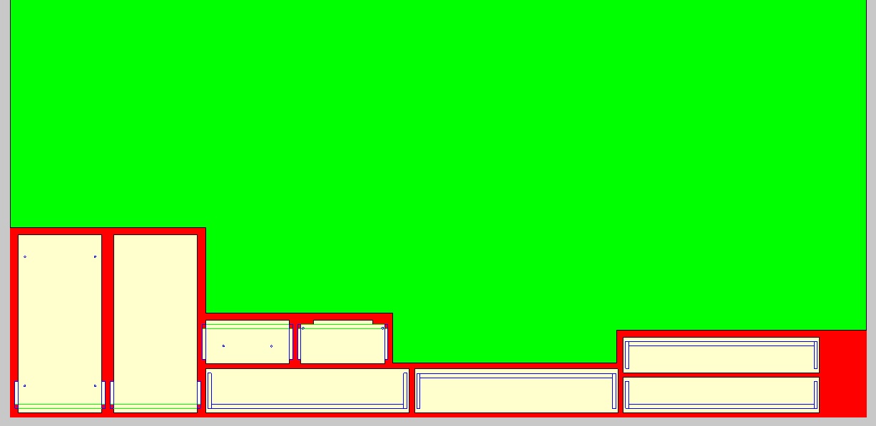

However, when I go to nest the cabinet the orientation of the dbx front and back are changed. Not sure what's going on here. Having tried rebuilding the drawer several times and I keep coming up with orientation correct in dbx editor but not in nesting.
I've attached pictures along with the dbx and cabinet file.
Nesting orientation issue?

Hi Donald, I changed the grain direction from 90 to 0 and it nested fine
