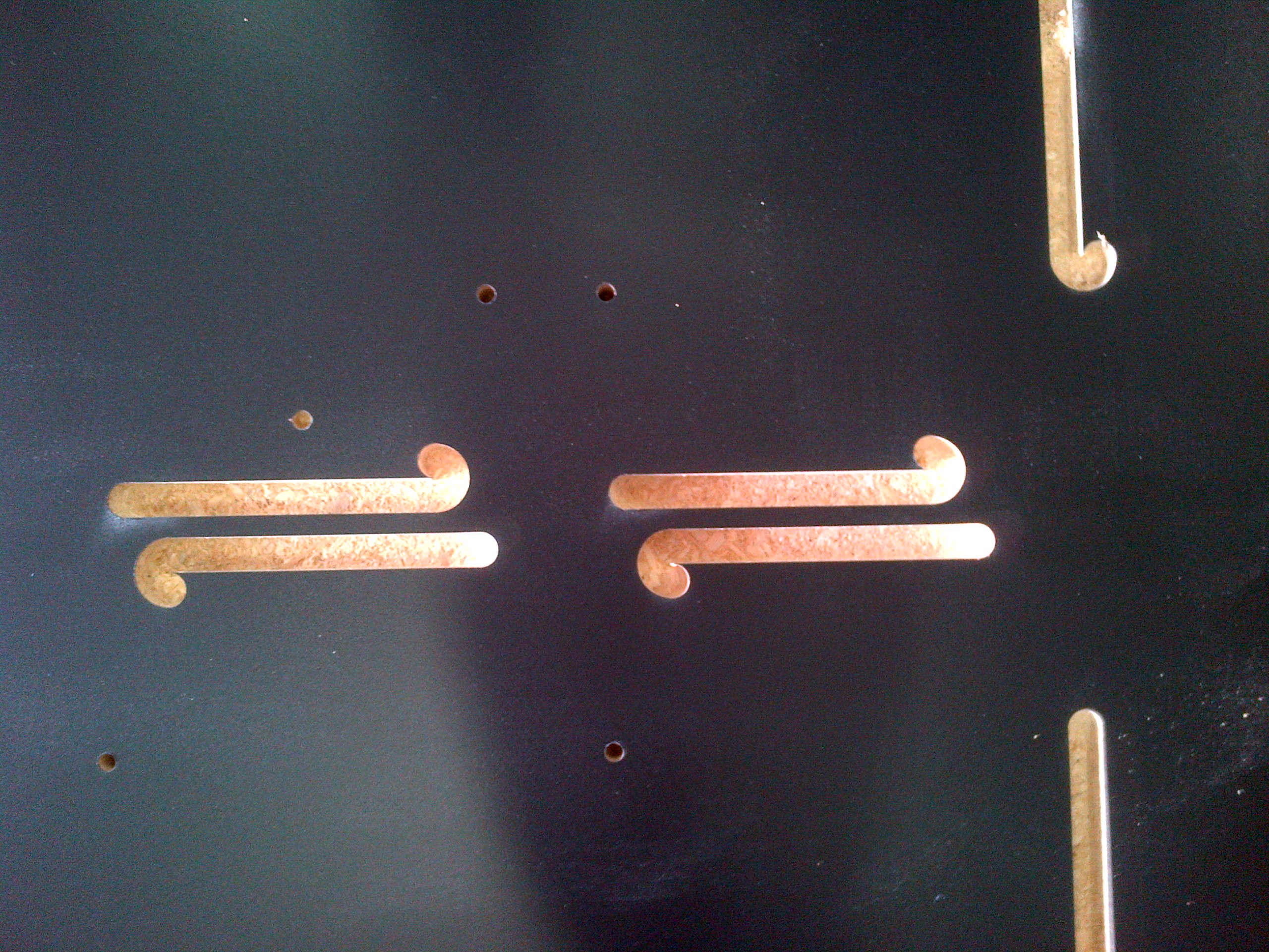

When cutting tenons of a certain thickness where the cutting depth is greater than the maximum depth specified for the tool, the result are the candy canes as per the attached photo.
When it returns to make the final depth pass, it does not do the candy cane.
Also, when moving from the end of the initial pass to the beginning of the next pass, it doesn't seem to be a G00 move.

Jeremy,
Can you post an export of your settings please? Also if you have the code from these parts being created, as well as the non rapid issue so we can compare that would be great.
