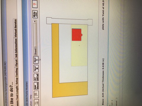

I don't know anymore how to set up so the cnc does not do a Pocket instead of a regular cut-out, I have a sink cut-out to do and it does it as a Pocket so it takes a lot more time to do it and I don't understand why it does it this way !! It's a part from eCab.

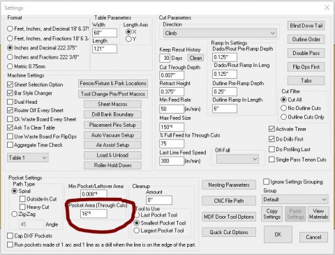

Most likely you need to adjust your Pocket Area (Through Cuts) value in Settings of Control Nesting. Any through pocket that has an area below that value will be pocketed out completely. Any through pocket with a value in area larger than that, will be cut around the edge, and the "plug" left behind. See attached screenshot for value to modify.

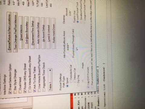

Does not seem to work ! Look at the pictures...

are you using groups?
make sure your changing the setting for the apropriate group.
my cleanup amount is always at 0" ...your settings look fine to me though.
