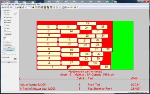

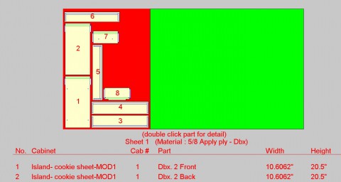

Couple of things I've noticed and was wondering if there are settings I need to adjust to change this.
First issue is the way I'm getting some parts kinda randomly placed on the sheet. "Picture 1" and "Picture 3" shows this. Part 34 and part 35 on "Picture 1" seem to be kinda randomly placed in the midle of the sheet instead of all the way to the right of the sheet. In "Picture 3" it seems parts are just randomly placed all over resulting in a significant increase in wasted material.

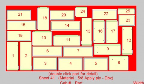

Second issue concerns some parts that don't seem to be getting laid out properly. "Picture 2" shows this. Parts 1, 2, 12, 13, 16, 17, 18 are the problem. In the drawer box editor, I have these parts set to be rotated 90 degrees. It seems that whether I set rotation for these parts to be 0 or 90, they get laid out as shown. I would like them to be laid out 90 degrees from what is shown (long way with the grain of the plywood, not cross grain). Am I using the rotate parameter in the material selection part of the drawer box parameters incorrectly?
Are there parameters that can be set/changed that would eliminate this?

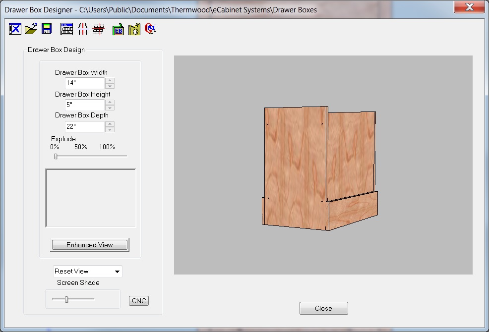

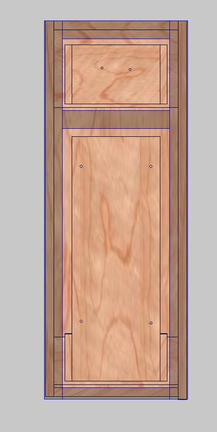

I doubled checked the material specs and it does in fact have the "has Grain" checked. I'm working with the drawer box front for the lower drawer in this cabinet. I've attached a screen shoot of how the part is displayed in CE. As you can see, the grain is along the long axis of the part. Yet, in the nesting it wants to rotate the part to be cross grain. Not sure what to do.

Thermwood, this seems to be very repeatable. Here's what I'm doing:
1. I have a sheet of 5/8" Appleply in my defined materials
2. Has grain direction is checked.
3. Created a drawer box that has tall fronts and backs but short sides (a trash can drawer)
4. In drawer box editor for the tall fronts and backs, I've tried setting rotate to 90 degrees and 0 degrees and the results are the same. The tall front and back pieces ALWAYS nest cross grain (when I test nest the cabinet) to the grain set for the 5/8" Appleply material.
All other drawer box parts nest correctly. Do I need to turn off HAS GRAIN in the materials list?
Look to your wisdom in figuring this out..
Thank you.
