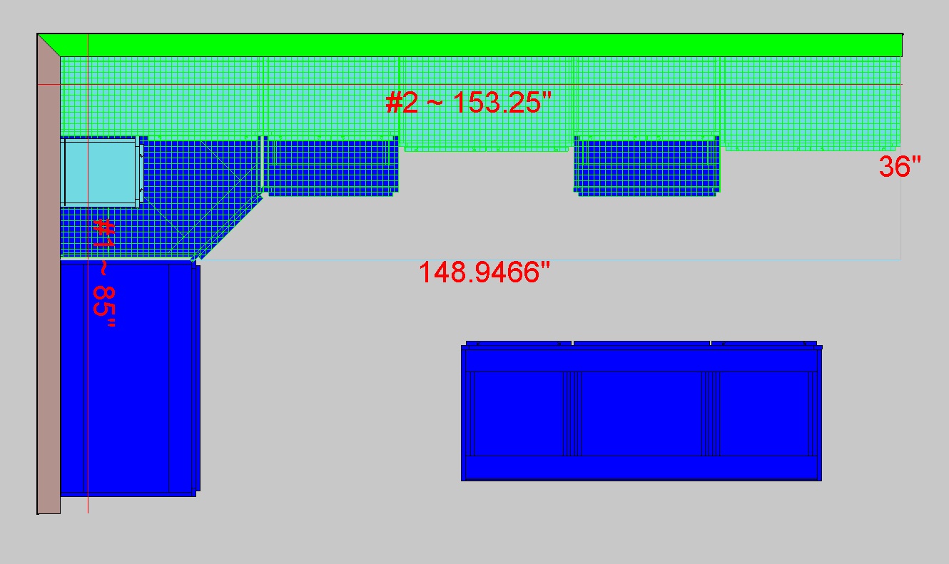

View of layout editor

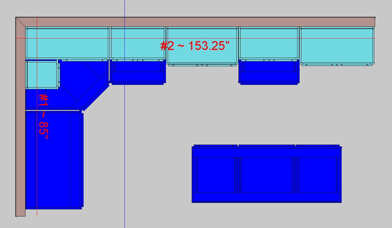

Cabinets selected for association to the selected wall

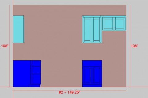

Press 'W' to bring up the wall and this is what I end up with
