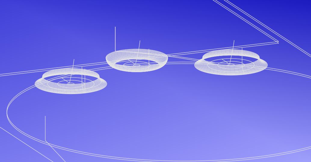

Re: Pocket Cutting Off Profiled Edge
Troy,
Not sure exactly whats going on with this one, I'll have to send it to the software engineers. The attached picture is the backplot of the code. Each of the white lines is the path the tool takes. So the center one that cut correctly has the correct shape. For whatever reason the outer two circles are going the wrong way. I'll let you know when I hear back from the engineers.

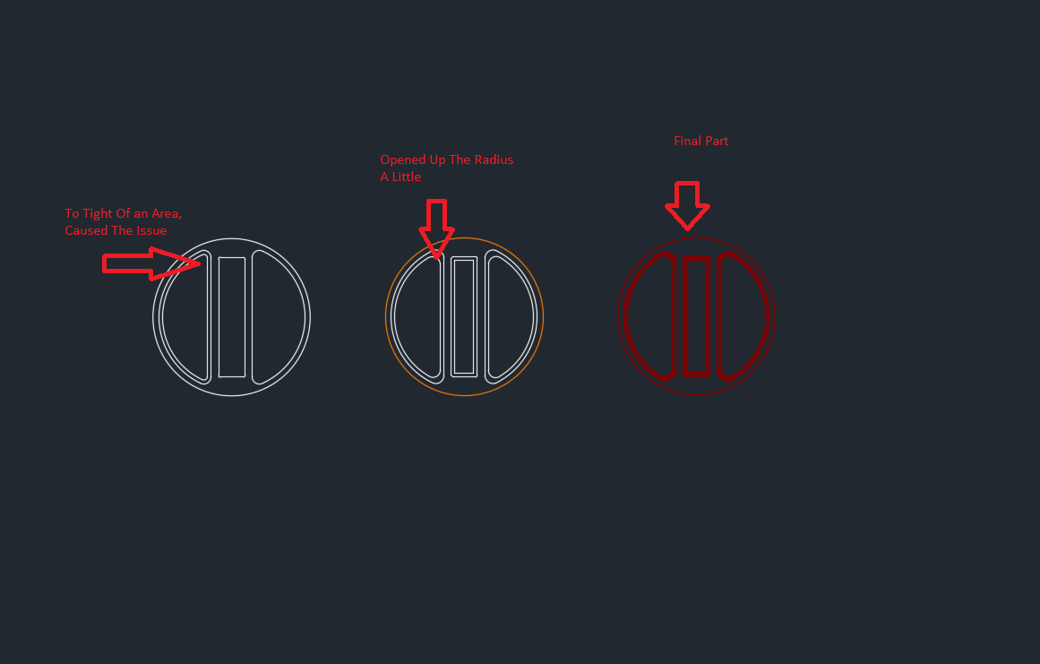

The Update did the trick my part cut fine. Now the customer made some changes and added another pocket with profiled edge and I get "Sweep not possible" error box. Any ideas?
Troy
Troy
Clint,
Sorry It took me a while to get back to you. I modified my drawing and was waiting on the outcome from the shop.
Attached is a picture of the changes I made to my drawing to get it to cut perfectly.
Thanks Again!
Troy
Thanks Again!
