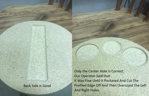

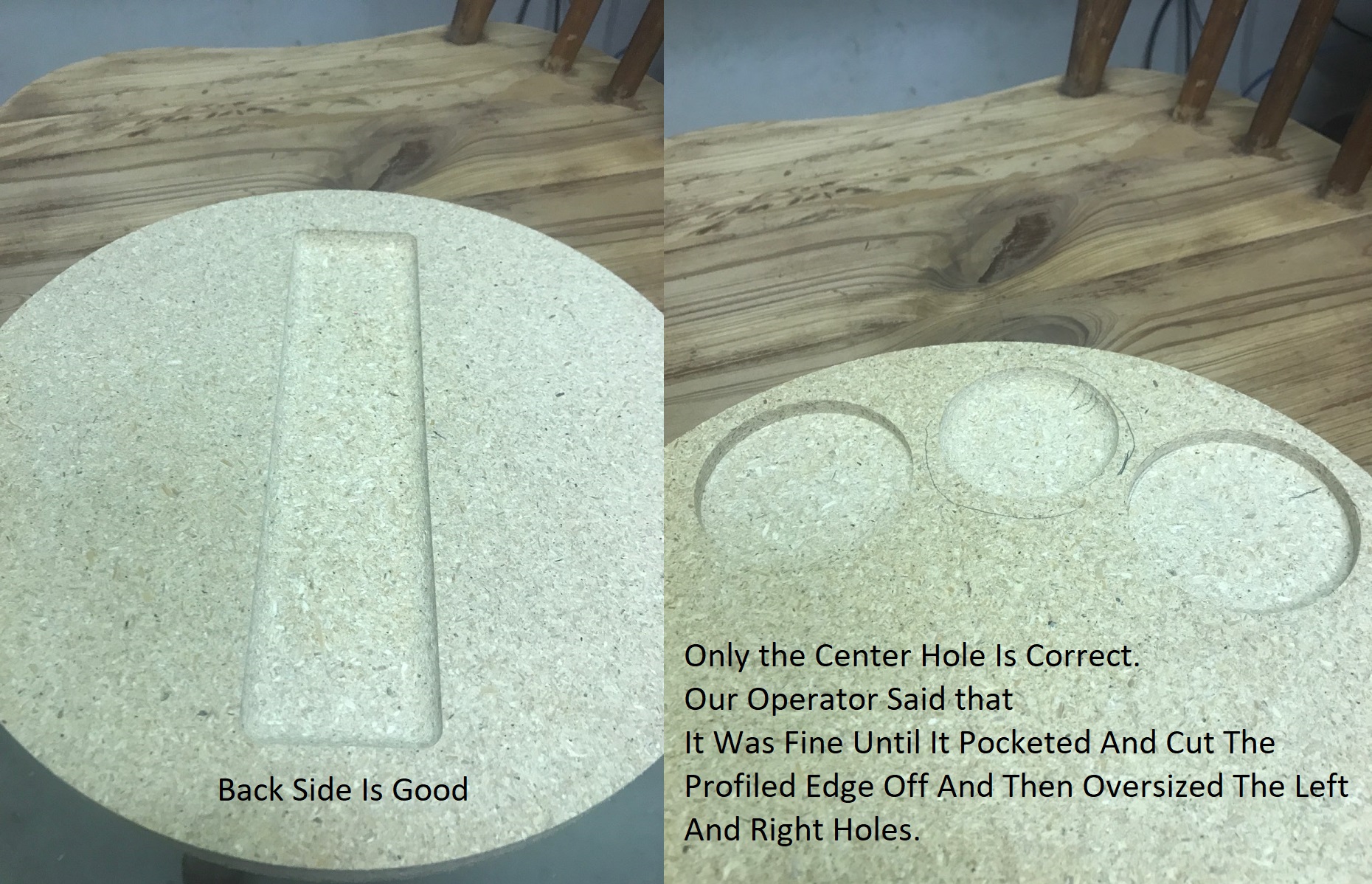

Hi Guys,
I'm not good at describing my issue and I hope that the photo shows whats going on. Ive included the ecabs file, A DXF drawing of the Front and Back sides and also the Profile Tool that I made (The Modeling Tool At the CNC Is a .5 Downsheer Bit). I've Started over 2 times trying to get different results but both times I got the same result.

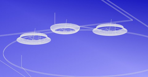

Not sure exactly whats going on with this one, I'll have to send it to the software engineers. The attached picture is the backplot of the code. Each of the white lines is the path the tool takes. So the center one that cut correctly has the correct shape. For whatever reason the outer two circles are going the wrong way. I'll let you know when I hear back from the engineers.

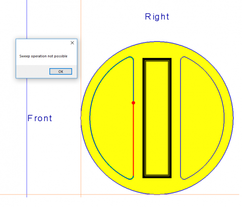

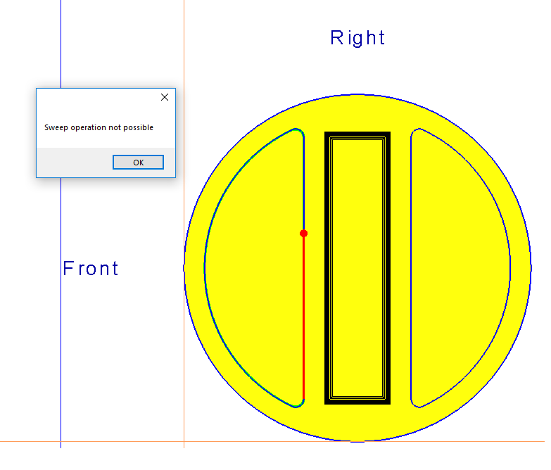

The Update did the trick my part cut fine. Now the customer made some changes and added another pocket with profiled edge and I get "Sweep not possible" error box. Any ideas?
Troy

Can you post the cabinet with the contour lines on it that you are trying to sweep? Also can you post the tool you are trying to sweep? I may be heading out early today so it may be Monday before I can take a look at it.

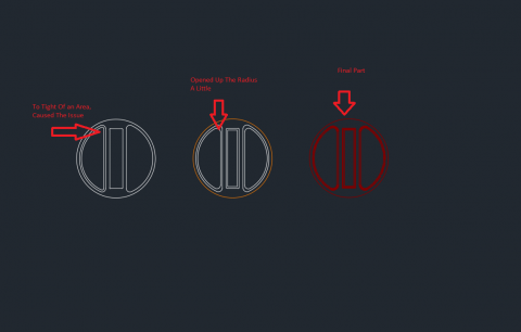

Clint,
Sorry It took me a while to get back to you. I modified my drawing and was waiting on the outcome from the shop.
Attached is a picture of the changes I made to my drawing to get it to cut perfectly.
Thanks Again!
