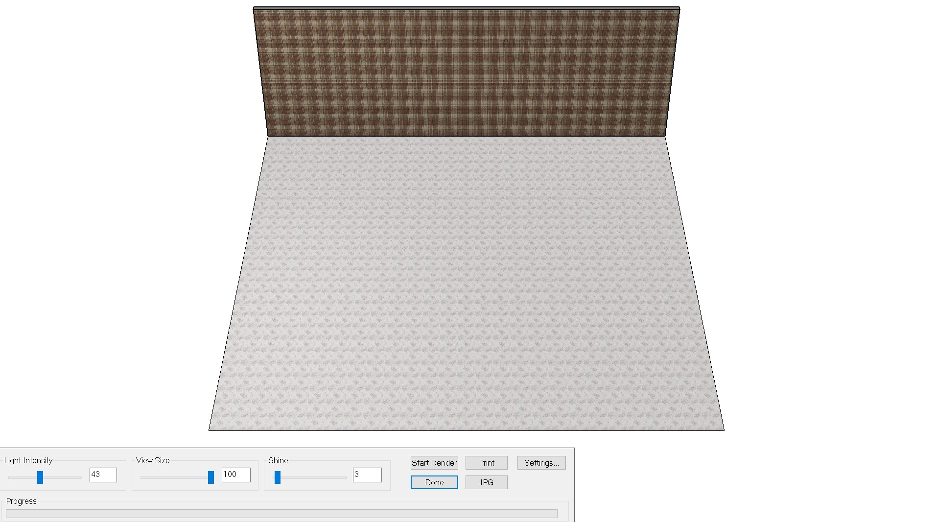

I tried to uninstall the program and start again but all the files stay... and when I create my wall I get this... This never happened before.

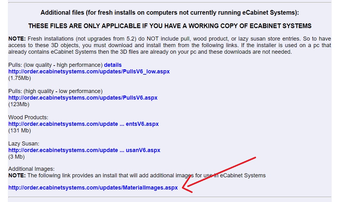

Hi,
I just installed the :
Additional Images:
NOTE: The following link provides an install that will add additional images for use in eCabinet Systems
From the web site. My wall is fine but I cannot generate the view... see picture.
Additional Images:

JR Allen
- Junior Member
- Posts: 84
- Joined: Sun, Mar 16 2014, 1:48PM
- Company Name: JRs Woodworx
Re: Presentation view not working
Looks like you need to set the tiling of the pattern. Done thru change wall texture.
