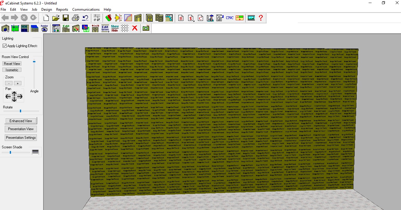

I tried to uninstall the program and start again but all the files stay... and when I create my wall I get this... This never happened before.

From the web site. My wall is fine but I cannot generate the view... see picture.

Looks like you need to set the tiling of the pattern. Done thru change wall texture.
