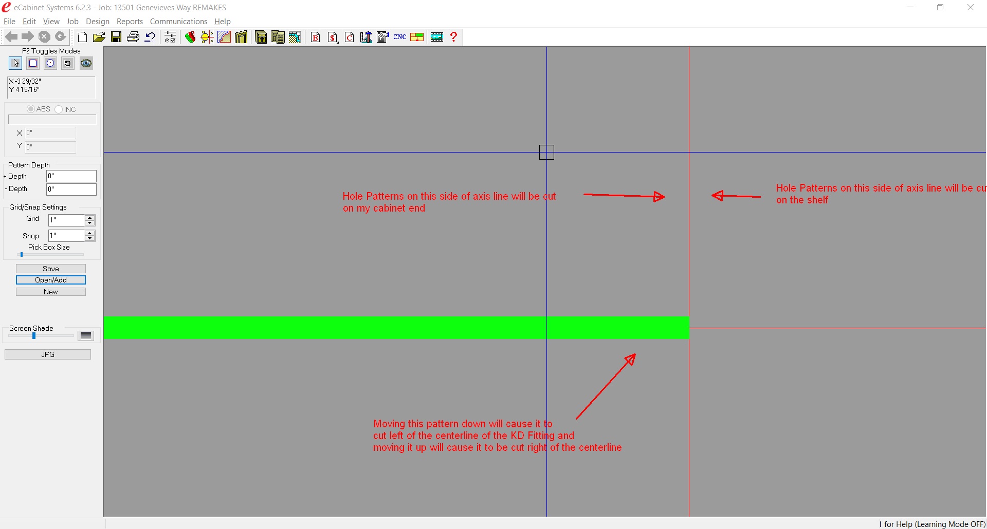

I did this in the past with a hardware pattern as you mentioned
The only problem was I had to apply a different hole pattern (for length) for base cabinets, tall cabinets and upper cabinets as well as different lengths for different heights of uppers. For a one off it is just as tedious as part editor cuts.
I applied the hole patterns to a phantom shelf. This allowed me to adjust the starting point.

This is what I was looking for, I just didn't have the head space to get into it because the job was a rush job. I had 3 different heights to deal with, and made dadoes in the part editor to match them on a seed cabinet, so I only had to draw them once for each gable and size. When I machined them, however they appear to have had the dado fit allowances applied, they were wide by the fit clearance. Not ideal but It was a fast solution.Stuart,
I did this in the past with a hardware pattern as you mentioned:
I am curious why you have the ptn drawn in that quadrant, rather than the x+,y+. And also rotated 90 degrees? I'm probably missing something there as far as machine theory. Thanks for the reply, and I will endeavor to get a good pattern going here sooner rather than later.

Stuart,
In the hardware hole editor I am not sure the lines are actual X and Y Axis.
As for my shelf, the pattern is drawn centered on what would be the x axis and runs left of what would be the y axis. This placed the cut on the end of the cabinet centered where my kd fitting would be. If I draw it on the left of the y axis it will place the cut on the shelf. This is how you do different hole patterns on different parts that a KD fitting would require.
