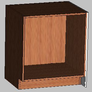

Is anyone else using applied ends and having troubles deleting them?
In the attached cabinet, I cant delete the right panel.
Its a little bit intermittent.The left end applied end also plays up for me as well, but in this example it deletes.
Std Base Frameless.jpg (14.48 KiB) Viewed 14665 times
Std Base Frameless.hsf
(276.02 KiB) Downloaded 1164 times
Anyone else with similar results?

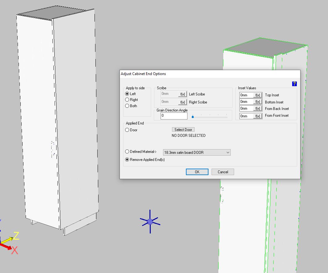

Are you selecting the side first (left/right/both) then remove applied - click OK

I installed the latest version of Ecabinets just now and tried the applied ends feature on your cabinet. I had no issue deleting the applied end that you had installed. You might have a gremlin :shock:

Ian surmised it correctly.
I have used the applied end feature quiet a bit and its great for setting up kitchens in custom layout.
I hadn't used it myself for about 6 months and forgot the selection methods.
Thanks for the help :)
