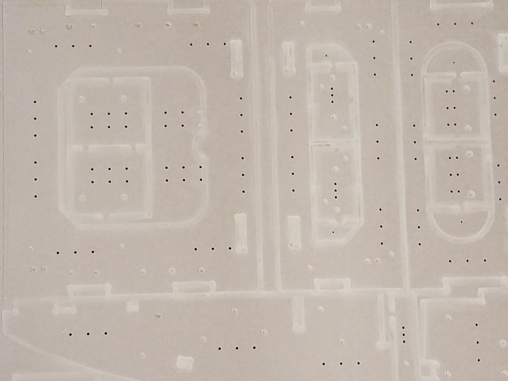

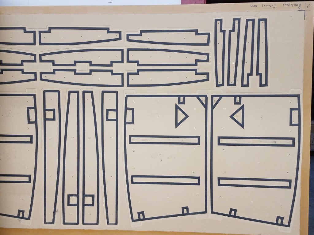

I've used custom spoilboards with great success. The gasket technique Clint talks about takes time to implement but is very effective for large runs. I've also used custom boards with just 3/16" through holes to direct the vacuum to the part. I've cut literally hundreds of sheets with the boards in the photos. For small parts that are mixed with larger cabinet parts in a sheet tabs and skins are about the only option.
