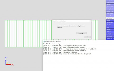

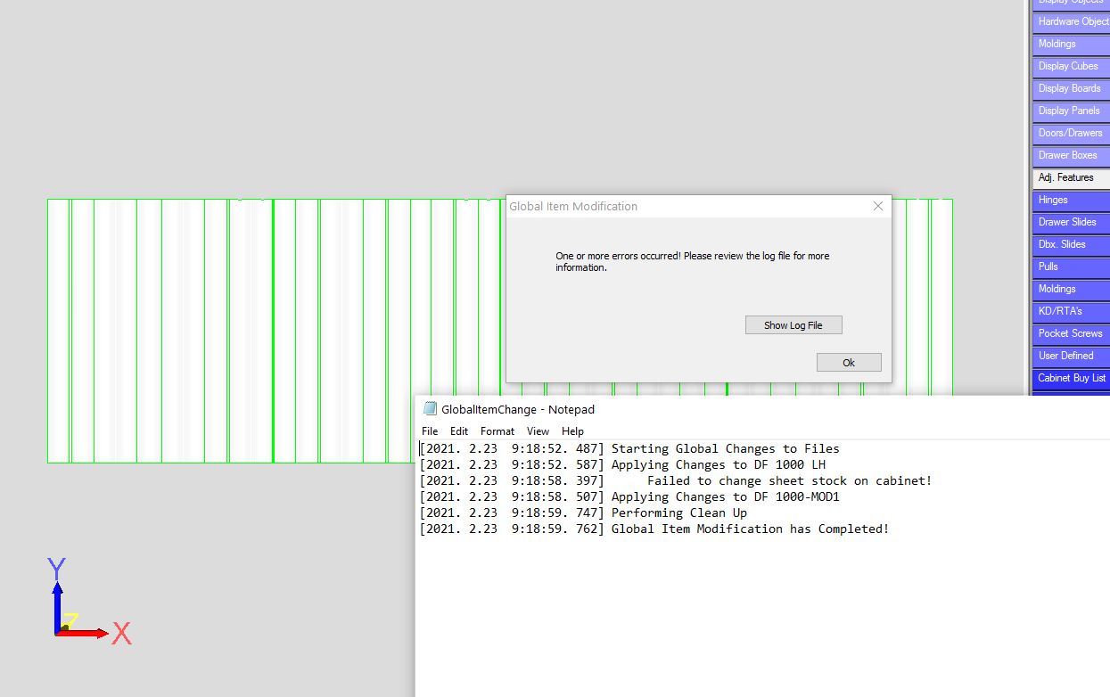

This error message appeared after I accidentally loaded 1 corrupted file in with 3 good ones and attempted to global modify the lot.

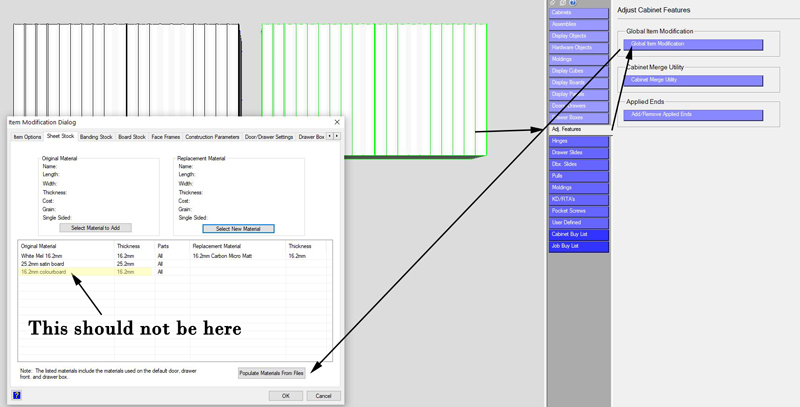

I keep on bringing this up, but why is there some random material from an earlier cabinet build still attached to the cabinet file?
If I check my materials in cut list I get a true result and no other materials.
When I nest sheets in ecabs its not nested.
But in global modification these phantom materials are getting read from a data set attached to the file.
In this case its the 16.2mm colourboard that is not there.
To my way of thinking all old materials should be purged from the cabinet data and the material list should only be the materials actually used in the cabinet.
Perhaps the data like the part editor cuts and hole patterns, in certain situations are getting assigned to the phantom material, therefor breaking the cabinet.
I have just tested this with 2 times with 2 other units with part editor cuts to the doors with the same results

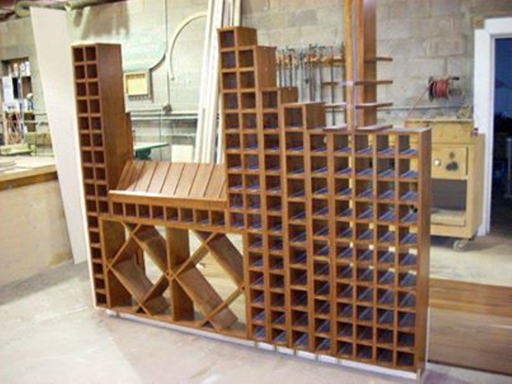

Just my 2 pence. We did do this wine rack in eCabs

Nice wine rack......... (Where is all the wine? :) )
