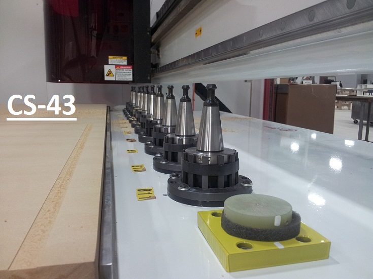

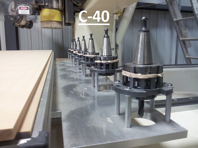

This Explains why would be extremely difficult to change Depth of the Bowl...
The tool holders on the C-40 are on stilts wich allow for a deeper grab, unlike the CS-43 wich cant go too far down because of the table...sucks...need try to make the vacuum pathway diameter bigger somehow

I have a 43 and have always had excessive dust/chip problems.
I am convinced the problem is the restrictions caused by the dust hood, as shown in Jason's post.
The cs40 has two 4" pipes where the cs43 only has one, but with the same work to do. Every book I have read tells me that "when you reduce the size of the pick up pipe from 6" coming to the machine to less then 4" or 3 at the hood you have reduced air volume, reduced velocity, and increased static pressure." Try this. Cut a board the way you normally would, then, with out moving the board from the router, disconnect the 6" flex hose from the spindle and hold it 1 " or so above the board you just cut. move it around and see how much dust/chips are being sucked up. This is what we should have picked up the first go around if not for the restrictions caused by the dust hood. One of these days I have to redesign this because its not just about sweeping the floor the dust on the parts is also a problem to clean up.
