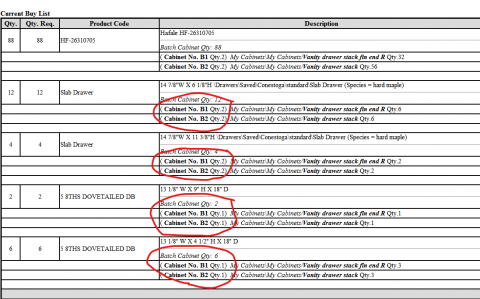

Download the batch, run a buy list, and look at the difference between how it represents cabinet quantities for drawerfronts versus drawerboxes. There are two each of two cabinets, the batch labels them B1 and B2.
For the drawerfronts, the batching correctly uses the quantity in the batch for each, which is 2. For drawerboxes, though, it only counts 1.

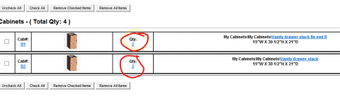

See attached

I have attached the job file, the batch in which cabinet B28, when the buy list is created, the slab drawerfront count is correct, because it uses the cabinet quantity (2) in the batch, but incorrectly returns the drawerbox counts, because it only counts for one (1) and not two (2) cabinets.
What is behind this strange behavior?

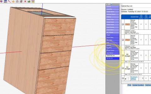

Thanks, but what is the buy list in the "Item Window?" Is it the per-single-cabinet buy list I access as I show in the attached screencap?

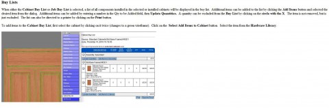

Re: Bad count purchased drawerboxes
Post by Clint Buechlein »
See attached screenshot from the eCabinets help manual.
