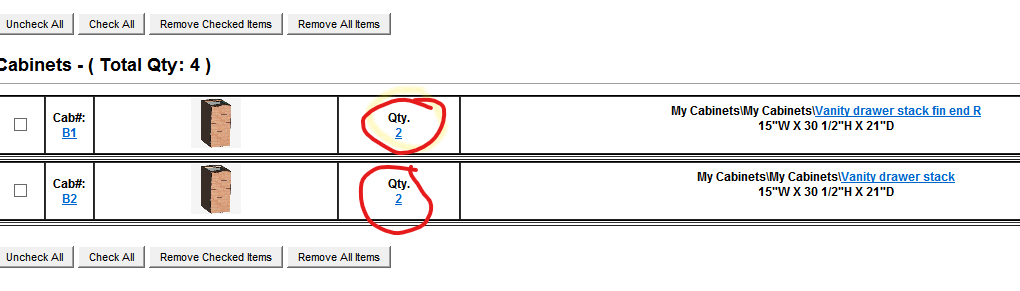

I have two cabinets, both base drawer stacks, identical except one has a finished end and the other does not.
One will not generate correct quantities for drawerboxes only, when I do a batch and look at the buy list.
Download the batch, run a buy list, and look at the difference between how it represents cabinet quantities for drawerfronts versus drawerboxes. There are two each of two cabinets, the batch labels them B1 and B2.
For the drawerfronts, the batching correctly uses the quantity in the batch for each, which is 2. For drawerboxes, though, it only counts 1.

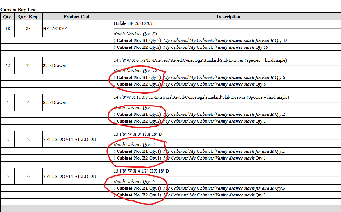

I have attached the job file, the batch in which cabinet B28, when the buy list is created, the slab drawerfront count is correct, because it uses the cabinet quantity (2) in the batch, but incorrectly returns the drawerbox counts, because it only counts for one (1) and not two (2) cabinets.
What is behind this strange behavior?
The nest runs correctly.

It boils down to this with me. ANY cabinet with drawerboxes (and mine are all purchased), when in a batch at a quantity more than one, gets its drawerboxes tallied in the buy list just once, while the doors and drawerfronts (also purchased) get tallied correctly.
A base cabinet with one drawer over a door. Purchased drawerfront, purchased door, purchased drawerbox.
Add it to a batch, quantity 2. The buy list shows two drawerfronts, two doors, but only one drawerbox. Attached is a cabinet that behaves this way.
What is it with the cabinet, to cause this behavior?

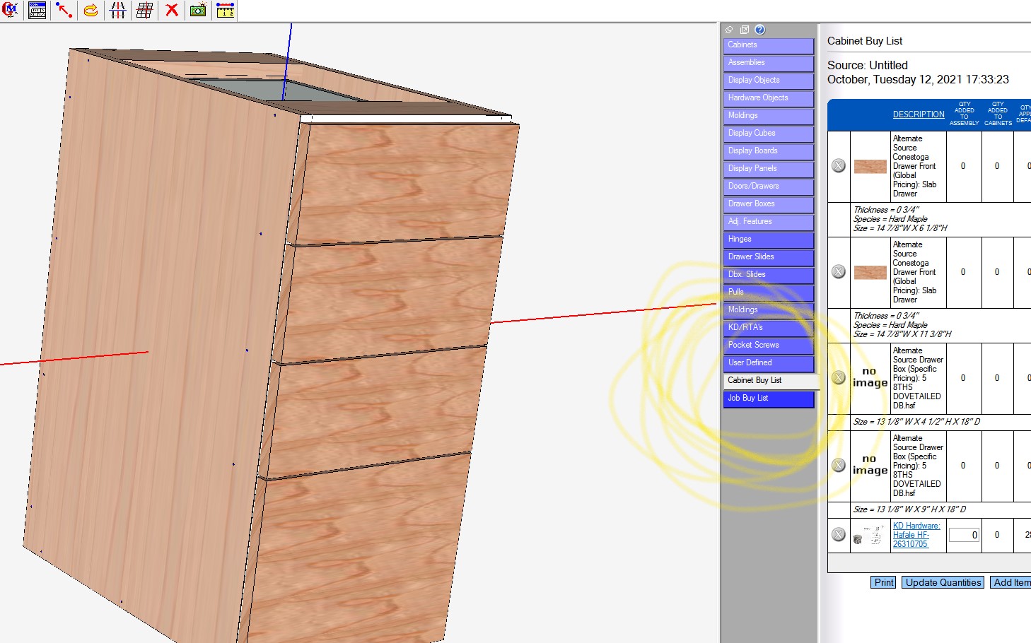

Just for the heck of it, I pulled up a three drawer stack and selected alternate price option. When I selected buy, It only showed two drawers, so you're right Gene, it's a bug of some kind. The cost sheet only shows two as well, but the cut list shows three.

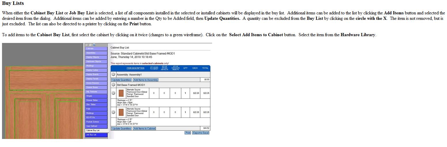

I see the same thing here using what we refer to as the "old" Buy List (the one available by selecting the B on the toolbar). I'll report it to the software engineers to fix.
In the mean time, you can use the "new" Buy List that is available in the Item Window. This list is displaying quantities correctly.

Re: Bad count purchased drawerboxes
See attached screenshot from the eCabinets help manual.
