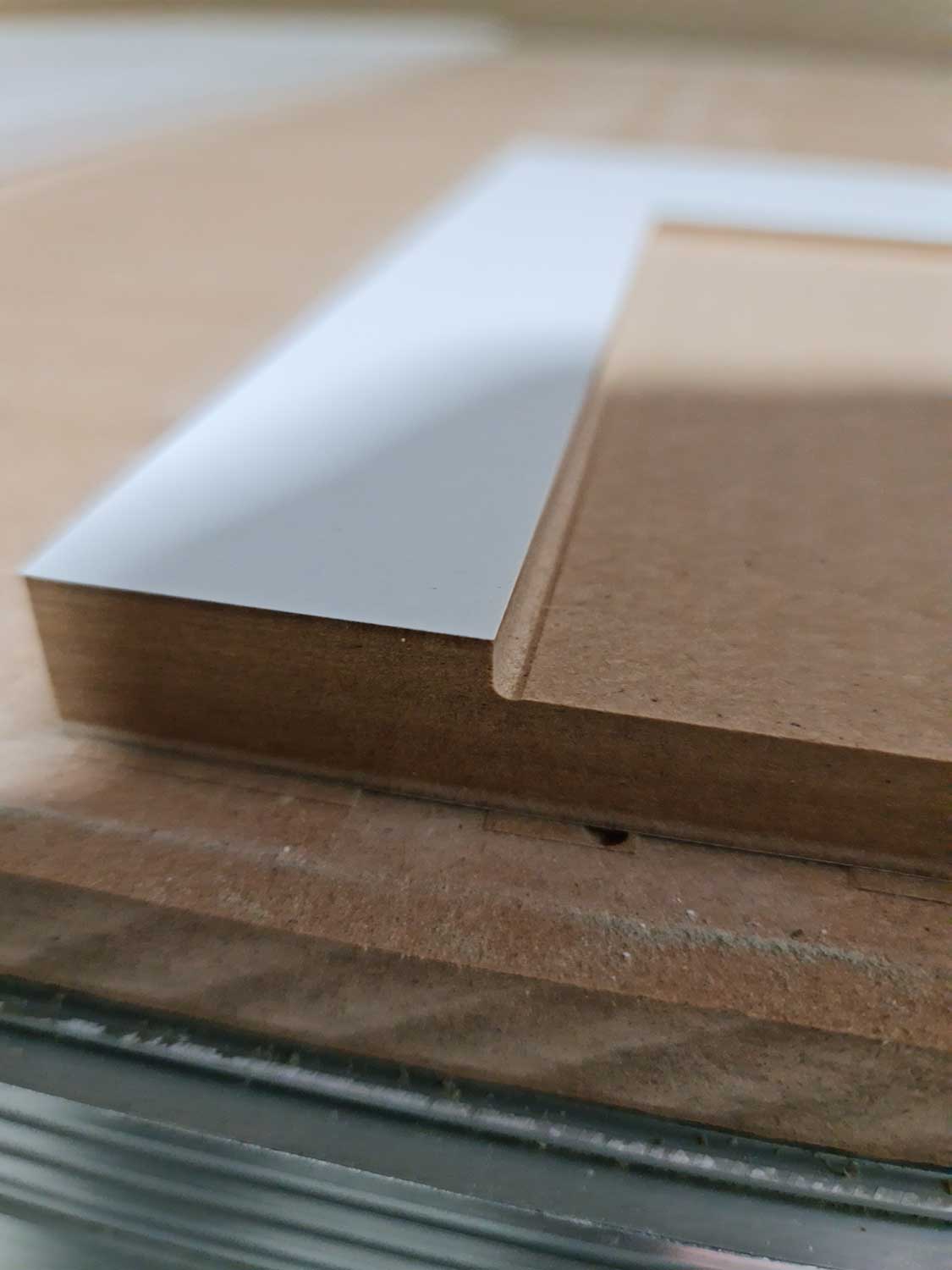

We just cut a job and all the doors had the cleanup groove cut deeper as in the attached photo.
Its supposed to be flat leaving just a small radius in the corner.
Is this what is fikxed in the latest update?
I tried a few things but couldn't get it out so we used cabinet scrapers on every door.

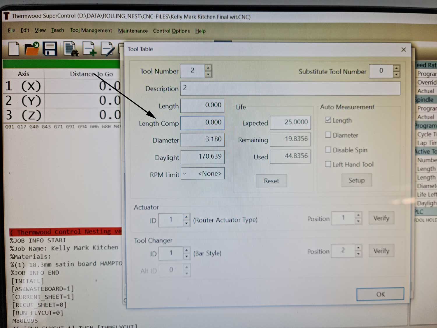

A question I had was regarding the length comp settings. I tried adding 1 mm before and after writing CNC but couldn't affect any changes that I could see. How does length comp work or what is it supposed to do?

The fix was for a scenario where a profile has been applied, then the cabinet resized and the error would come up. With the error you wouldn't be able to get to making a .twd. Your scenario looks like either daylight is off on a profiling tool, or an unexpected tool was used to profile (at least looking at face value).
Length comp is primarily for 5 axis, more so older 5 axis. Technically you could do it in 3 axis, but it's a long way to go about doing what the machine is set up to do.

I replied to your email before looking at the CNC file. The pocket and the pocket cleanup are both commanded to go to -5 in Z. Is it supposed to be a radius at the bottom of the pocket? If it is supposed to be squared, my initial thought is a ballnose bit was loaded in place of an endmill and the ballnose bit was out of the collet further than the endmill making the cut deeper.

It would appear to be the round nose one that is cutting deeper than it should by about .4 / .5mm. The flat pocketing tool is cutting at 4.9 consistently.

I had forgotten / or never knew that you could change the daylight value.
Now that you have brought it to my attention it could be something that will get used a bit more.
