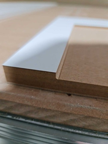

We just cut a job and all the doors had the cleanup groove cut deeper as in the attached photo.
Its supposed to be flat leaving just a small radius in the corner.
Is this what is fikxed in the latest update?
I tried a few things but couldn't get it out so we used cabinet scrapers on every door.

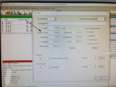

A question I had was regarding the length comp settings. I tried adding 1 mm before and after writing CNC but couldn't affect any changes that I could see. How does length comp work or what is it supposed to do?

The fix was for a scenario where a profile has been applied, then the cabinet resized and the error would come up. With the error you wouldn't be able to get to making a .twd. Your scenario looks like either daylight is off on a profiling tool, or an unexpected tool was used to profile (at least looking at face value).
Length comp is primarily for 5 axis, more so older 5 axis. Technically you could do it in 3 axis, but it's a long way to go about doing what the machine is set up to do.

I replied to your email before looking at the CNC file. The pocket and the pocket cleanup are both commanded to go to -5 in Z. Is it supposed to be a radius at the bottom of the pocket? If it is supposed to be squared, my initial thought is a ballnose bit was loaded in place of an endmill and the ballnose bit was out of the collet further than the endmill making the cut deeper.

I've checked the tool sensor, its good and flat without center point wear and measuring on the center point.

Take an actual measurement of the flat depth of the pocket and the bottom of the ballnose bit's path. See which one is correct. That will help you point to where the problem is. Both should be the same as the CNC code tells them to go to the same depth so one is giving you wrong results.

It would appear to be the round nose one that is cutting deeper than it should by about .4 / .5mm. The flat pocketing tool is cutting at 4.9 consistently.

I went back again and closely inspected the tool sensor. bingo. I need glasses.
I had epoxied up a divot in the top of the sensor in what only seems a short while ago, so I had half convinced myself that couldn't be the problem.
Of course repeated measuring was also just digging it deeper.

Glad you got it figured out. With cutters like that (ballnose, MDF door, anything pointy or odd shaped) we keep them chucked in tool holders and never remove them. Measure them, adjust the daylight manually until it's perfect, then never remove it from the holder.

I had forgotten / or never knew that you could change the daylight value.
