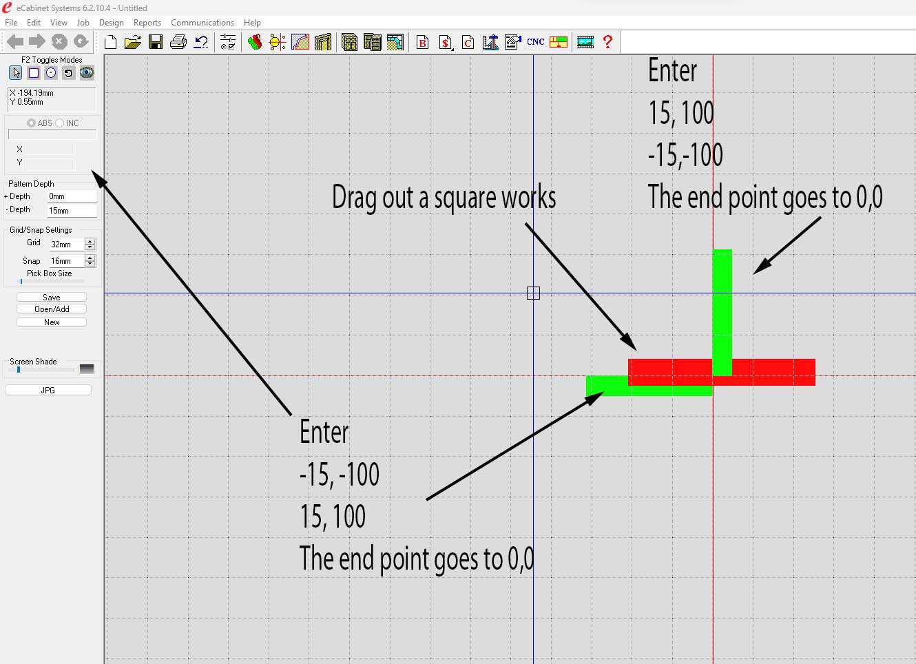

I am trying to create a square hole for some recessed handles in the hardware hole editor.
I can drag out the square pattern but when I try numerical entry of the co-ordinates the first dimension takes but the second dimension defers to 0,0
Does anyone else have the same results?

Notice that when you enter your first set of coordinates and hit enter the entry method changes from Absolute to Incremental.
This happened to me as well the first time I tried this. When it happened, I selected the ABS radio button again and everything worked from there.

That"s very perceptive Kerry!
I hadn't noticed that.
And when I switch it back it works for me.
A little tricky test for the noobs like me.
I failed................
Thanks for your time and help again.
