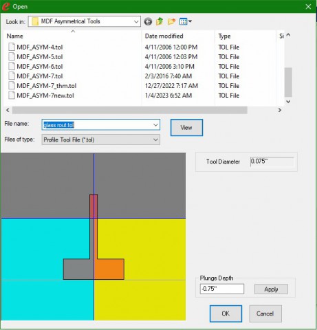

Our bread and butter is institutional PL cabinets with slab doors. In the past when a glass panel door was called out, I'd fab a rabbeted frame in the traditional manner, using solid poplar 1x core, running vinyl edge banding on the inside edge of my frame parts before cutting the cope and stick lap joinery, and a few pins and glue would secure the joints. Then I'd apply my PL to both sides, and trim rout the waste from the "panel" area, run the outside edges thru the edgebander, and voila, a door that is time consuming to build but is strong and has the correct finishes (don't forget the slot for that rubbery glass retainer) on all the inside and outside edges.
I'd like to build a slab door from medex, with pl both faces and a single rabbet for letting in the glass on the back, to be secured with adhesive. I'd like it to be parametric to the applied cabinet, and receive any appropriate lock or pull options just like a regular door. It will require a flip-op if designed like I think eCabS wants it to be, but if I can somehow force it to cut (and correctly dialog in CN) all ops from the back, that would b e preferable.
I've started in the door designer with a custom slab door, but I can't seem to get this right. Anyone been doing this yet in eCabS? TIA!
Making GLASS panel slab doors

So the way I interpret what you need is a rebate to the back of a standard flat door? What I call a pre-finished double sided melamine board, and I think what you refer to as PL is plastic Laminate which is the same thing.
Do you need the slot as in your picture of the profile tools? or just the rebate? The slot is beyond my capabilities, (Its something that I would be interested in knowing if it could be done as a cutpath attachment in the constraints manager area)
But.
If I was doing it, I wouldn't bother with putting a profile edge to the inner edge, I would just do them as pockets and let control nesting cut them when it is doing the hinge holes.

Mark, You're moving me forward! I don't know why I got to thinking it had to be a "MDF" door, but the slab is much simpler! As usual, I'm over thinking it, and when I stumble, I look for a different solution.
I had tried to constrain a slab door, but changed direction when I couldn't get the constraints to work. Then, while watching your video, I realized I was trying to constrain an edge (the rabbet, to the through cut) to another constrained edge, and it was not working. I'm a dummy, because you need to (obviously,
) make your reference anchors on the door edges, not the rabbet edges. BINGO, slab works.
