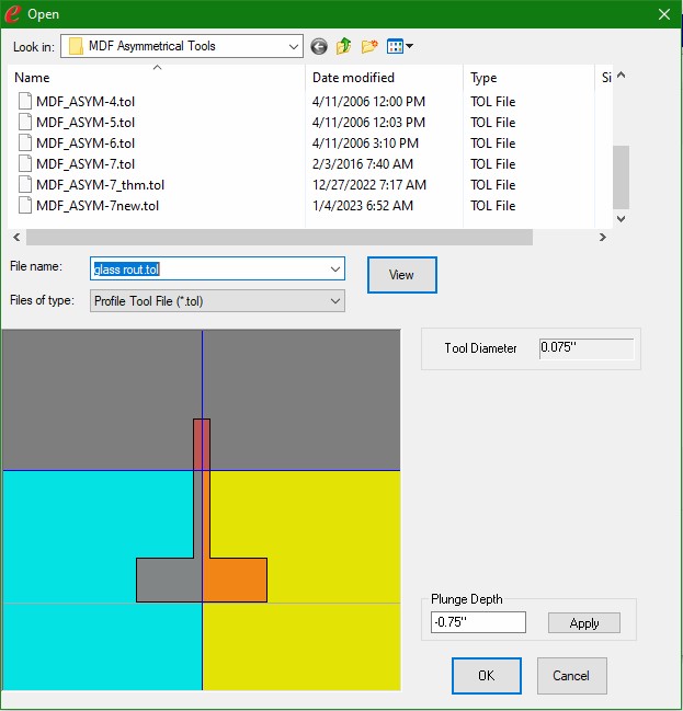

Our bread and butter is institutional PL cabinets with slab doors. In the past when a glass panel door was called out, I'd fab a rabbeted frame in the traditional manner, using solid poplar 1x core, running vinyl edge banding on the inside edge of my frame parts before cutting the cope and stick lap joinery, and a few pins and glue would secure the joints. Then I'd apply my PL to both sides, and trim rout the waste from the "panel" area, run the outside edges thru the edgebander, and voila, a door that is time consuming to build but is strong and has the correct finishes (don't forget the slot for that rubbery glass retainer) on all the inside and outside edges.
I'd like to build a slab door from medex, with pl both faces and a single rabbet for letting in the glass on the back, to be secured with adhesive. I'd like it to be parametric to the applied cabinet, and receive any appropriate lock or pull options just like a regular door. It will require a flip-op if designed like I think eCabS wants it to be, but if I can somehow force it to cut (and correctly dialog in CN) all ops from the back, that would b e preferable.
I've started in the door designer with a custom slab door, but I can't seem to get this right. Anyone been doing this yet in eCabS? TIA!

So the way I interpret what you need is a rebate to the back of a standard flat door? What I call a pre-finished double sided melamine board, and I think what you refer to as PL is plastic Laminate which is the same thing.
Do you need the slot as in your picture of the profile tools? or just the rebate? The slot is beyond my capabilities, (Its something that I would be interested in knowing if it could be done as a cutpath attachment in the constraints manager area)
But.
If I was doing it, I wouldn't bother with putting a profile edge to the inner edge, I would just do them as pockets and let control nesting cut them when it is doing the hinge holes.

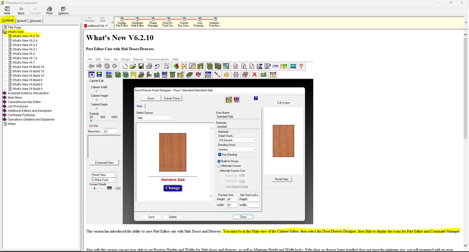

Stuart Douglas wrote: Thu, Oct 05 2023, 9:44AM Interesting to note:
The part editor and constraint manager buttons don't always show up in the door/drawer-front designer pop-up window! They are conspicuously missing in the pop-up when any screen other than a blank "Cabinet/Assembly Editor" screen is displayed. That may have led my initial efforts to be directed at the "MDF" design template, instead of the slab door.
Stuart,
This is by design. The Part Editor code itself lives in the Cabinet Editor for cabinet parts. This is why the drawer box designer is on the second tool bar and you have to be in the Cabinet Editor to design the boxes. We muddled around what to do when Part Editor was added to doors, and ultimately it was decided to leave the icon where it is so all other doors could be designed or modified outside of the Cabinet Editor. The other option would have been to move the Door/Drawer Designer to second toolbar and only accessible in Cabinet Editor.
Also, this is noted in help manual if you are curious. Both in the What's New section and the section about Door/Drawer Designer. If you don't, any time you install a new version of eCabinets, I encourage everyone as their first step after opening the software is to check the What's New section. This will tell you what is new to eCabinets, and any critical information about it. You won't get a step by step of how to use it, but at least you are pointed in a direction.
