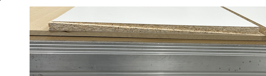

Just updated to the news control nesting 7.08 and thm software 11.3.5
When cutting off fall it only does a proper outline cut on 2 of the edges per piece and left a ramp in on the other two edges. Attached is the cnc code and some pictures. Not sure if anyone else has run into this. I have been able to duplicate it yet.

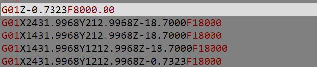

Okay, we just had this issue, cutting simple rectangles. What causes the issue in our case is changing the quantity of parts from the Load screen in CN.
Start CN, go to Manual Panel Input, define a panel (I did 1000x1000mm) and add it. Nest and write CNC, and it will be fine. Go back to the Load screen and change the quantity, re-nest and write CNC, and you will see this ramp in issue. In our case, the pre-plunge depth is supposed to be 7mm, and it seems to either be ignoring that, or pre-plunging to .7323mm.

Here is a snippet of the CNC code cutting a rectangle. Notice the tiny pre-plunge amount, and the fact that it actually ramps back UP to that amount on the last line.

Jeremy Schiffer wrote: Thu, Mar 07 2024, 12:09PM Did 7.09 address this issue? We had to roll back to 7.07, and I'm hesitant to install the new one.
Yes, should be corrected for 7.09.
