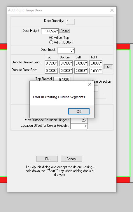

New update new Problems
If I erase a Door or face and reinstall it is always coming the same error, the same when i load Default faces and doors.
Please see attached pictures.

Does it do it with the Standard Slab door or just your door(s)?

Standard Slap Door and faces

Can you take the Standard Framed or Framless cabinet and get me exact steps of what you are doing to get the error? I haven't had any issues or reports from other users so we need to narrow down exactly what is going on. Using a standard cabinet from the Standard library along with the Standard Slab door that come with eCabinets is a best case test so we can narrow the issue.

Those doors are broken, there is information missing from them in their saved file. Those error messages are not ones you want to push through and continue work, it will only get worse. I'd suggest new door/drawer designs, Global Item Modification your library of cabinets, and see where you are when the dust settles. Make sure the check the box for Change Default when you use GIM so that old door/drawer is gone completely.
