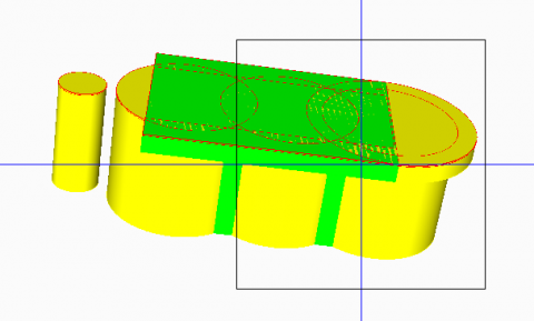

Trying to setup Cabineo's in eCabinets using the hardware hole editor. I have everything drawn up properly with the yellow holes, and the green rectangles (to do flush mount cabineos you need both), and my machine is only cutting the holes out, not the rectangles/"pockets". They are all in the negative direction, to the right of the X axis so they would bore into the side of the drawer box front/back. The holes drill out just fine, but the rectangles don't. Not sure what i'm missing.
I attached a drawing for anyone not familiar with what a cabineo is. The yellow hole to the left is the bore into the end of the mating KD fastener panel and appears to be in the right location. I can't test without cutting the green pockets as well.
