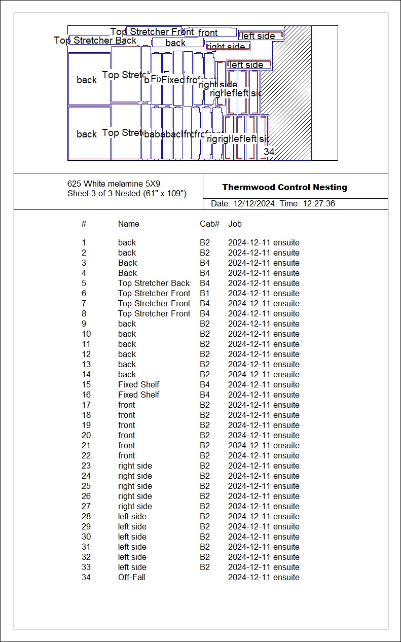

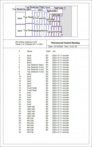

Hello All,
please see attached image from our thermwoods.
When we print our labels and then print to screen the label maps we have been getting a odd layout/info
As you can see in the top image it is printing the description of the part and not the number.
We have also had where it prints a number that is not associated with the parts listed below.
Any suggestions?

Steve,
The setting you are looking to change is under the print settings. Go there, then Sheet Settings. Within there uncheck the box for Use Part Name on Part. That will put the number on the part that coincides with the # column. The number it is printing on the image is for part #34 in the list, the off fall.
