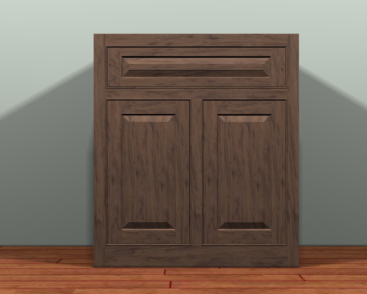

Y' all mean like this?
Funny thing, I was in a meeting with my regular millwork supplier around the time of Gordon's original post. I've been wooing them to produce a higher end version of the built-ins that most of their builder & homeowner clients have produced on site, with quicker turnaround and virtually as many options as the custom cabinet suppliers they currently use for NON built-ins. One of the main concerns of this company was options, and in particular beaded faceframes. (This millwork company also just started up a cabinet division, reselling different high end lines with their own name stamped on them -- my company is in line to sub-contract installs.)
So I was about to begin what I thought would be a P.I.T.A. process to achieve not only the look for the drawings which I'll have to produce, but also a usable file to have machined somewhere, or at the VERY least an accurate cut list. It took me all of (as Dan Epps said) 10 minutes. The tool took about 30 seconds, drawing the path for Part Editor to follow with said tool took about 30 seconds for each rail and stile, add a few minutes to figure out that path numerically and play with the Part Editor until it chose the path correctly, load the cab, load a door, put the saved cab in a room and render it, type this up, etc..... 10 minutes.
I wonder if beaded faceframes are something that the developers would consider as a feature? The reason I ask, other than the obvious, is, it seems like a very cut and dry process (software wise) to achieve it. For instance... an input box to determine the inset value which would automatically extend the top and bottom rail dimensions as well as reshape the stiles for the cuts, then pick a profile from a predetermined list OR have the option to create one using the Shape Manager.
eCabs....limited only to our own imagination.... :D
Mike
BTW I can't count how many 'custom' cabinet lines out there don't actually produce beaded faceframes. They use a 3/4\"x1/4\" moulding pin nailed or glued to the rails and stiles. What does that mean? Jack squat, 'cept for the fact that y'all could just make the lil moulding in the part editor and apply it to the face frames, associate to the cabinet, etc....etc....etc.

Mike,
That is a very nice look. Showing graphically correct mid stiles and rails could get a bit time consuming though.
At least your 10 minute design turned out something better than my 2 or 3 minute design did. That's why I would spend a full 10 minutes if I was actually going to use the design fo something. :wink:

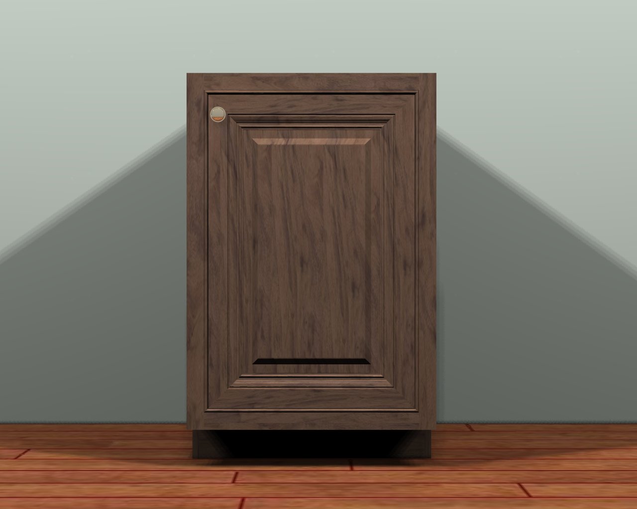

Kerry,
You couldn't be more correct! This one took 30 minutes, although I'll admit 10 minutes of that was trying to add doors and the drawer front in the Cabinet Editor. I eventually had to add them in Custom Layout.
For some strange reason, even though I've never so much as clicked on the Constraint Manager icon, after I added the doors and drawerfront in the Cabinet Editor and clicked on 'Main' so I could save the cabinet, it always crapped out and 'reverted' while trying to reapply constraints! Is this a known problem? The funny thing is, I even backed out of the software, rebooted, started clean and loaded the cabinet with the faceframes already beaded and tried to add the doors/drawerfront. Same thing every time; when I click on the 'Main' icon to return from adding the doors/drawerfront it starts 'reassembling' the cabinet and stops while 'reapplying constraints' (even though I haven't touched the Constraint Manager').
Pretty annoying.
BTW, I've already started an Excel Worksheet to do the math for numerical input on the paths/cutouts for the beading process - I like to work with absolutes instead of drawing paths by hand. So timewise it won't be TOO bad, but I still would like to see this whole thing automated and added as a feature.
Mike

Mike,
Very nice work. I hope Gordon gets to see that.

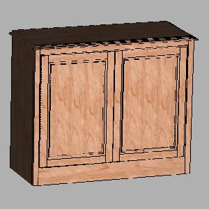

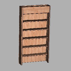

I played with this a bit. Dan, why such a big haunch? It should just be the size of the bead and nearly invisible.
Yes, I know the thread is ancient, but I needed a beaded FF and this is what search produced.
I don't know if anyone had made a different try at it, but here is mine.
