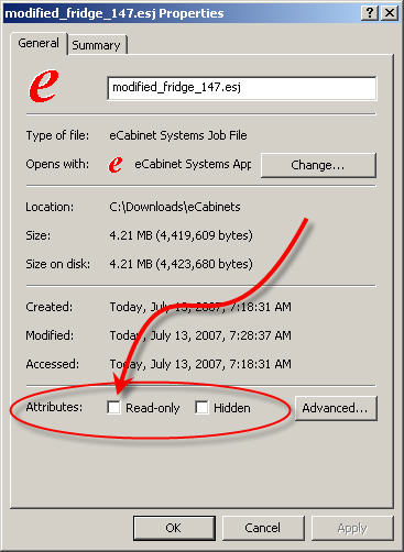

One other thought--how did you move the files from the old computer to the new one? If you put them on a CD (and sometimes on a jumpdrive) they will be set to \"read only.\" If this is the case you will have to change the file permissions to allow it to be written to.
To do this, right-click on the file (in Windows Explorer) and choose \"Permissions.\" At the bottom of the dialog, make sure \"Read Only\" is not checked.
read Only.jpg (40.51 KiB) Viewed 12477 times

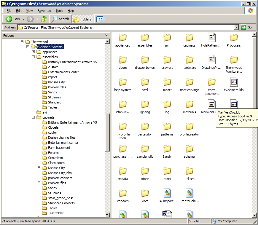

George,
Please stick with me to the end of this, and don't feel insulted if this is too basic. This was a little confusing to me at first, until I got it!

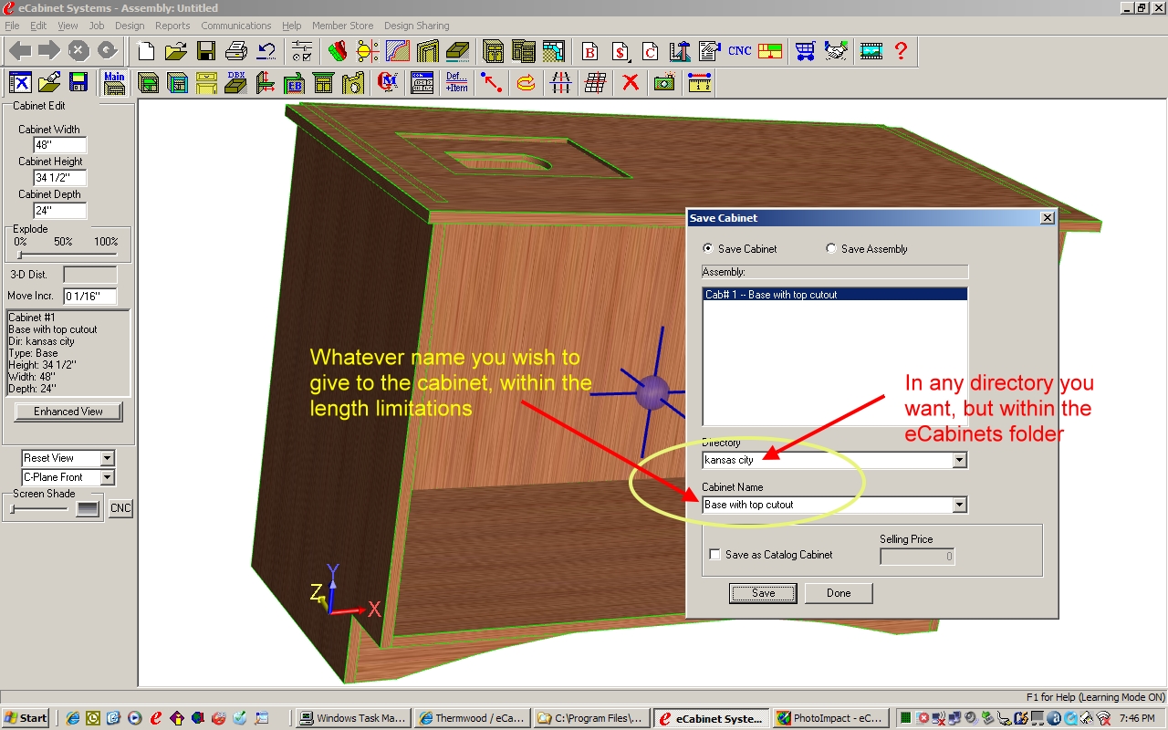

As Dan already highlighted, the folder to which you save the cabinets must first exist; and, since the cabinets you create (from modifying standard cabinets) cannot be saved to the "Standard Cabinets" directory, you MUST name the directories to which you save the various cabinets.
Please look at the file structure I have to date for both assemblies (more than one cabinet in the same file, file extension *.esa), and cabinets. These folders can be created within eCabinet Systems itself, or you can create the various folders with Windows Explorer (or whatever Vista calls it now...).
Now, whenever you save your modified cabinets, you can save them to any of the directories you created already, or to a new directory. For example, eCabinets will accept a new, or an existing directory name when you save a cabinet - AND these are created within the eCabinet Systems directory.
The same principles apply to saving assemblies. They all should reside within the main assemblies sub-directory of the eCabinet Systems folder.
You can also navigate the file structure within the eCabinet Systems file structure when you are ready to save.

The file structure within Windows Explorer

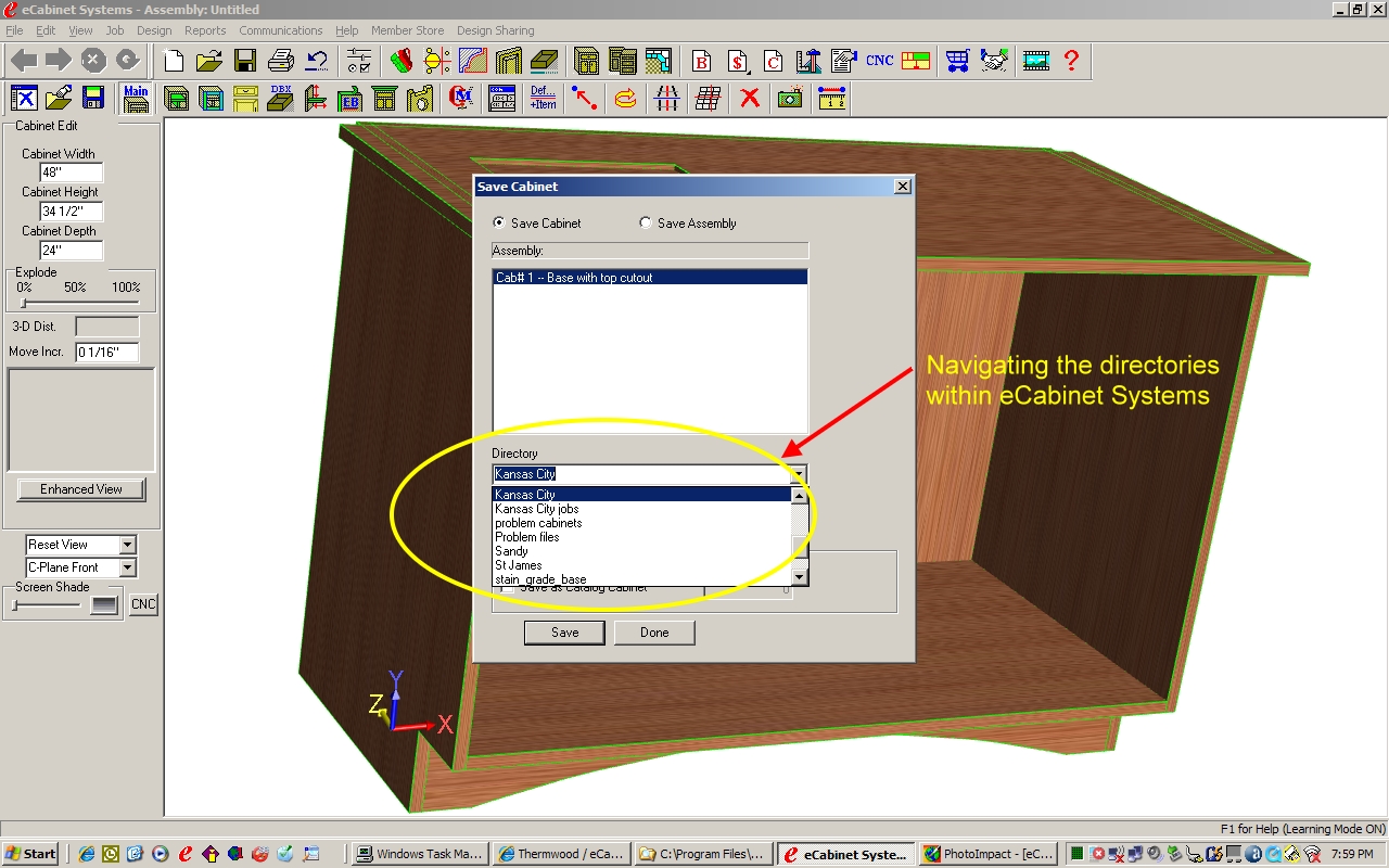

The directory and name at the time of saving the current work
Navigating the directories within the eCabinet Systems folder

Michael,
For cabinets and assemblies: When I try to specify a directory such as C:\\Jobs, I get an error stating that I used an invalid character (in this case, the backward slash, \\ ).
HOW do you specify this particular directory when you save to it, as you mentioned in your post? I am using WinXP Pro on a Dell Precision M90, etc. Thanks!
On the other hand: Jobs and job files saved from the Custom Layout DO allow you to specify a particular folder, as regular Windows navigation IS allowed from this area. Is this what you meant? In your post you did mention job files, specifically. If this is the case, YES, you CAN do it from there, but nowhere else.

One more thing, or two, or three. I am winging this one, just to make sure to CAN get on the right track - look at the file structure I posted earlier, and then print it for reference as you read THIS post:
Simple Rules:
1. ALL cabinets are saved to the cabinets folder inside the eCabinet Systems folders. A cabinet is a SINGLE cabinet, with NOTHING ELSE added.
2. An assembly can consist of cabinets, display boards, display cubes, vendor items, etc., etc. In other words, if you ANYTHING other that a plain old cabinet, THEN it becomes an assembly.
Just remember these two simple rules, and you won't go wrong. THIS is the reason you don't have to specify WHERE to save either cabinets OR Assemblies, other than specifying a directory name (which will be a new directory nave created either within the assemblies sub-directory, or within the cabinets sub-directory of the eCabinet Systems folder.
