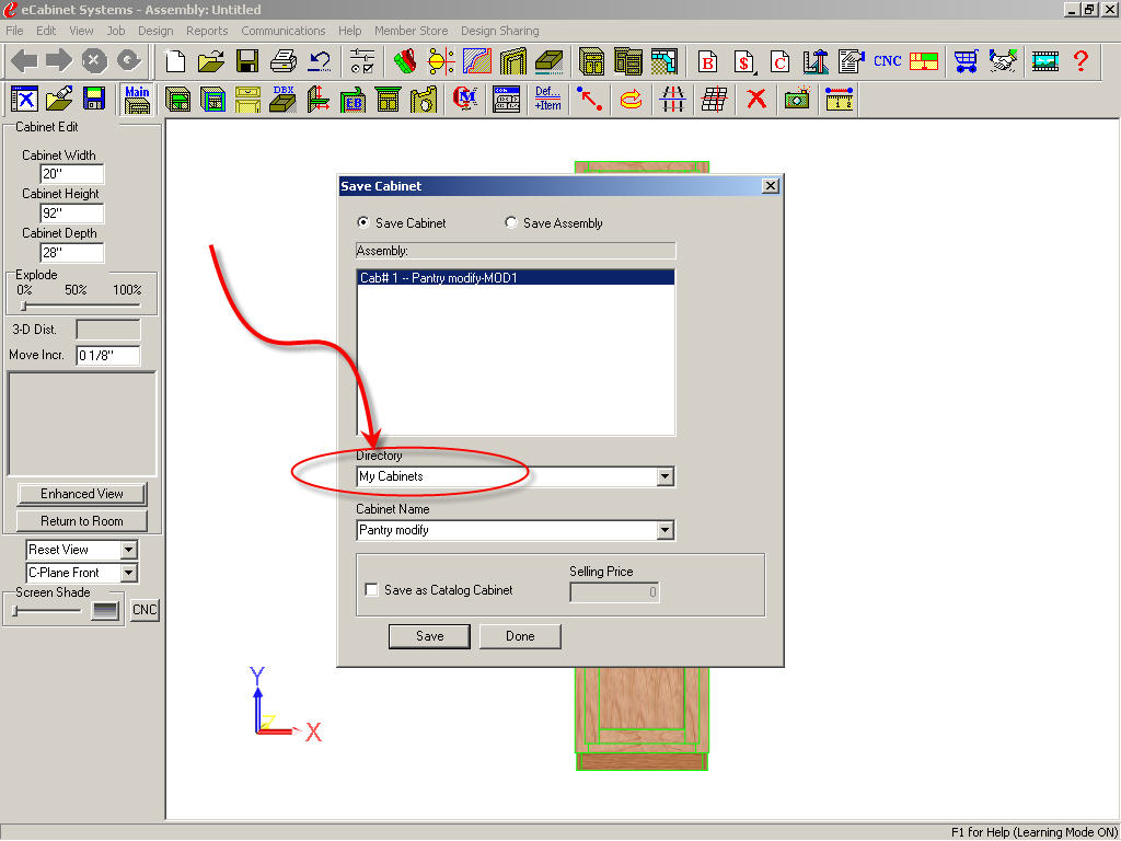

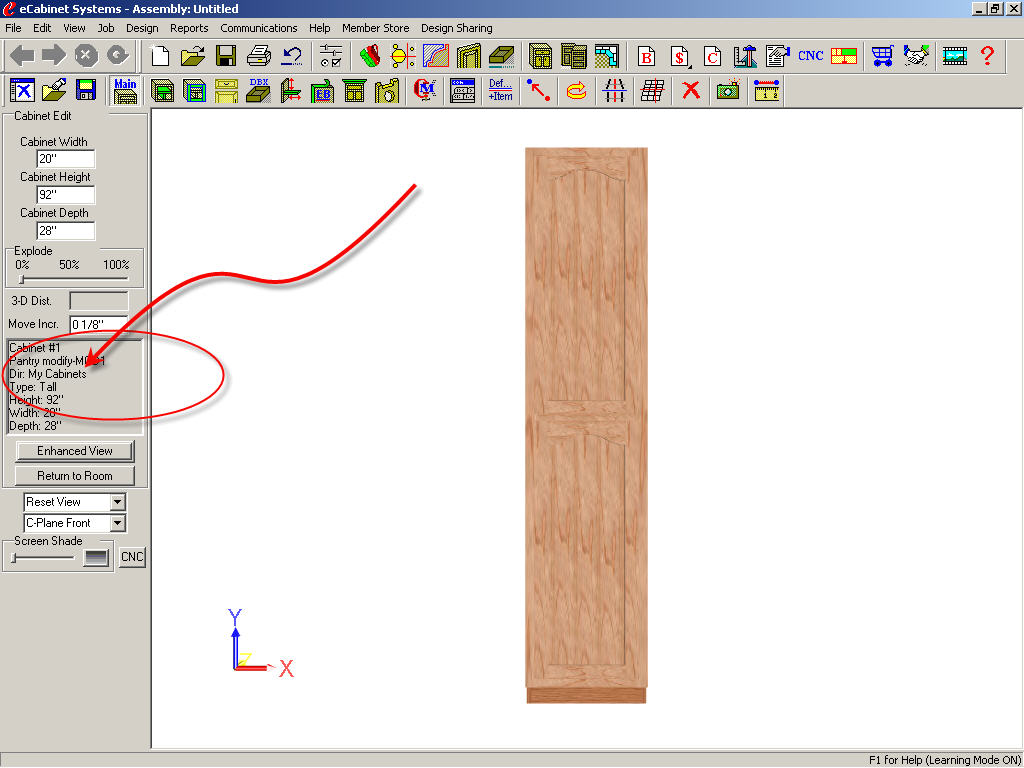

Al Navas
Posts: 443
Post by Al Navas »
George,
I downloaded the job, moved the microwave, two of the uppers and one of the countertops, then saved the file. Everything saved ok.
Just this afternoon I downloaded and installed Build 4, which is what I used to do this test. I wonder if Build 3 still results in the same problem?
Al
I haven't looked at the job file you attached, but here is my guess. You said you previously stored your cabinet files (HSF) in a directory named \"My Cabinets\" and you no longer have it.
When eCabinets is first installed, it creates only the standard cabinets directory which you cannot save to. You have to create your own directories for your seed cabinets.
If you are trying to save cabinets in the standard cabinets directory it won't work. The job itself references the location of the cabinets in it and is probably looking for \"My Cabinets\".
Try creating that directory (when saving a seed cabinet) and see if that helps.
I opened your job and here is what I was referring to. I was able to save the job with no problems as well but I also have 5.1 build 4 installed.

George L Vought
Posts: 85
Joined: Fri, Feb 16 2007, 2:00PM
Post by George L Vought »
When I'm done with this post, I'm going to download build 4 didn't know there was one :roll:
Ok so if I understand you right Dan, I have to go back in and save all of the cabinets I've ever built (my seed cabinets) into \"MY Cabinets\" folder and the program will then be able to recognize them???? I was afraid it was going to be something this simple :oops: :oops: :oops: :roll: Should I have named the file My seed cabinets????, or is that a personal preference?
