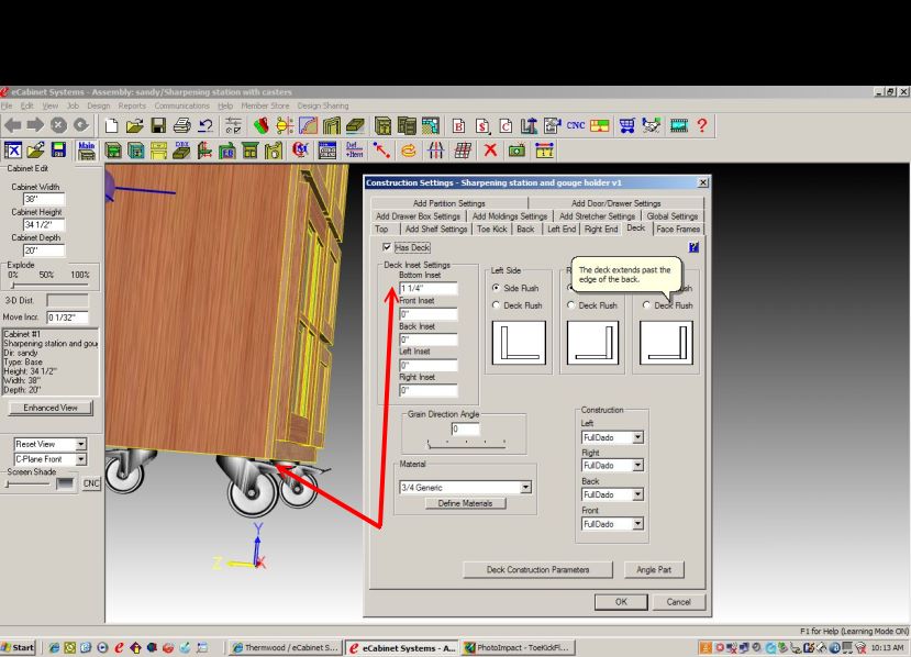

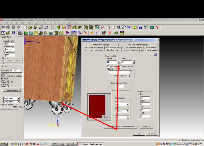

I've been trying to figure out how to get a toe board on my cabinets, and get rid of the excess end of the cabinet where the toe board goes. Can you help?? I've been trying out the more complicated parts, such as part editor and line editor. How do I make moulding for around the whole room and not just on the cabinets?? When I try to take it to the part editor it says moulding can't be altered. Also, can I use a display board for a ceiling and how do I adjust lighting through it??

George L Vought wrote:...I've been trying to figure out how to get a toe board on my cabinets, and get rid of the excess end of the cabinet where the toe board goes. Can you help?? ...
I post two images that should help you get the sides flush with the bottom edge of the face frame.

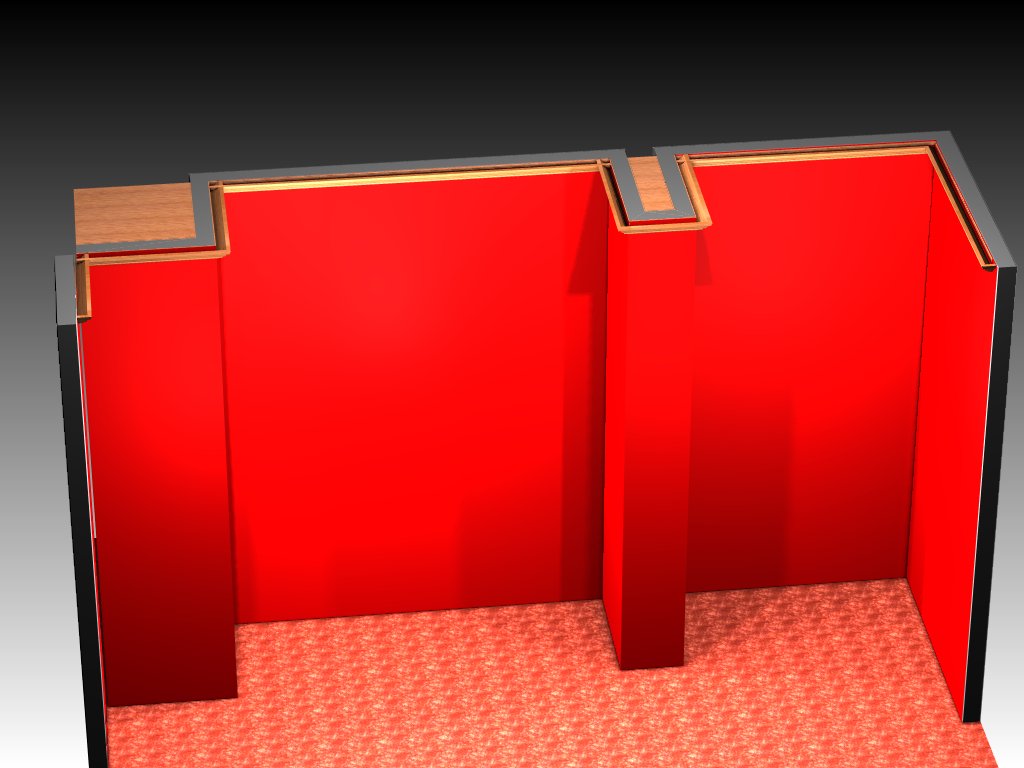

Molding around the room
Here is one I made up for a room
It is 5 Cabinets they go ceiling to floor and corner to corner.
Each red wall is the back panel of each cabinet it is 1/16 T
Corner Cabinet 48\" x 48\"

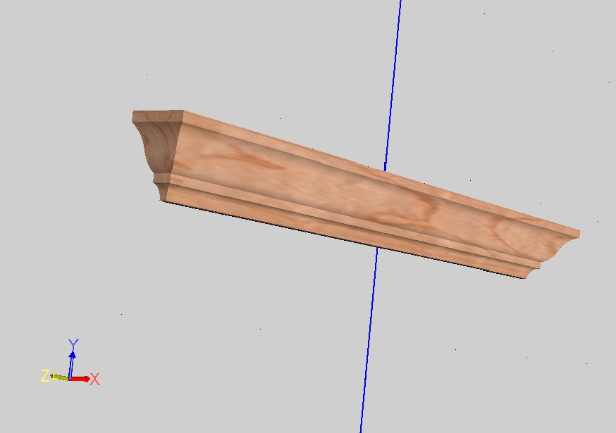

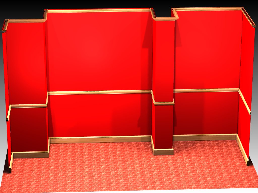

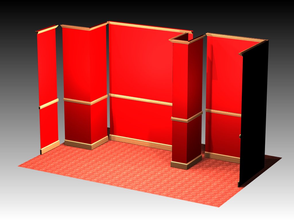

That is exactly the look I'm looking for. I don't understand the back panel concept though. I see the two cabinets in the first picture, but how did you get the moulding on the back? And where are the cabinets in pictures 2 and 3?? Do turn the cabinet around before installing the moulding? I haven't played at this part very much so bare with me. I think it's a look most of us are trying hard to achieve though. Seems everybody wants some sort of crown on top, chair rail mid-section and baseboard.
It's all in the insets George! Play around with positive and negative insets on your mouldings. Also uncheck all the parts of your cab except the back which you make from 1/16\" material. That way when you place your \"cabinet\" in the room your mouldings will be re sizable.
This moulding here is mounted on a top that is made from 1/16\" thick material. The cab depth is 1/16\" and all other parts have been unchecked. It takes a bit of time to get used to constructing like this. George D. has a very good grasp of this. HTH
