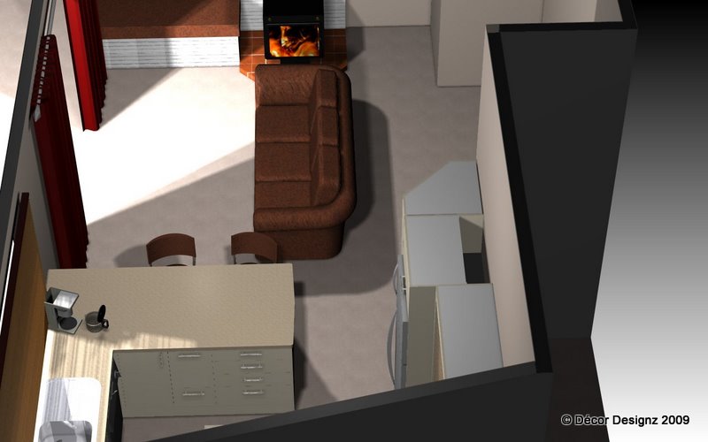

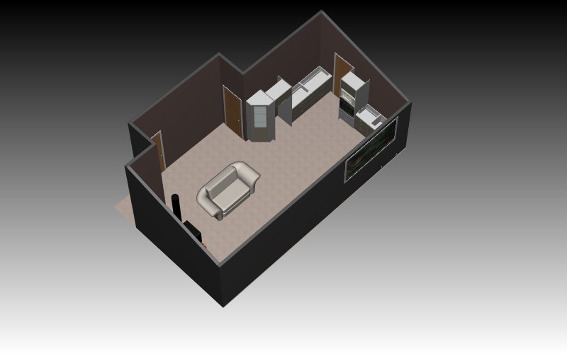

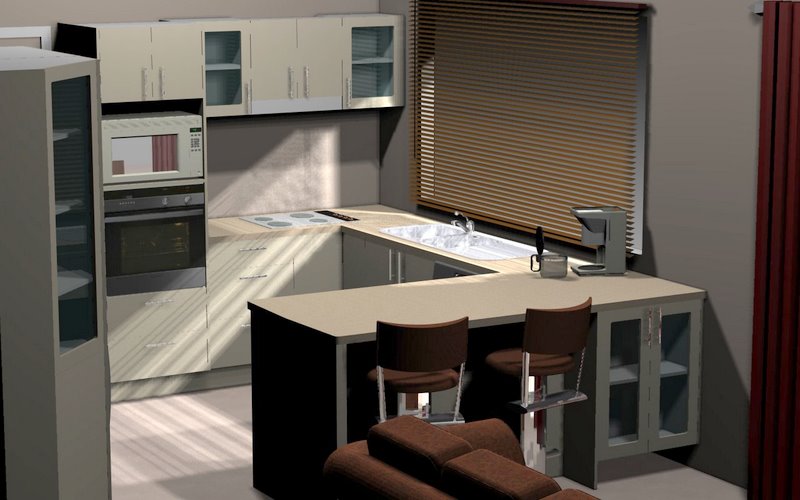

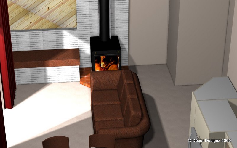

Hi Folks
Here is the finished design of the room I was having trouble with. Just thought you might be interested.
Thanks again for all your help.

Re: Program Crashes with slanted walls
Bryan,
Excellent rendered views. The light through the blinds is spectacular.
