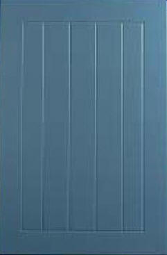

Hi we supply doors from a supplier that molds the MDF substrate and then laminates a vinyl to the front.
You can find them here http://www.arborlinedoors.co.nz
My questions is this, is there an easy way that I am overlooking to display a door or drawer in the style showen in the attached picture.

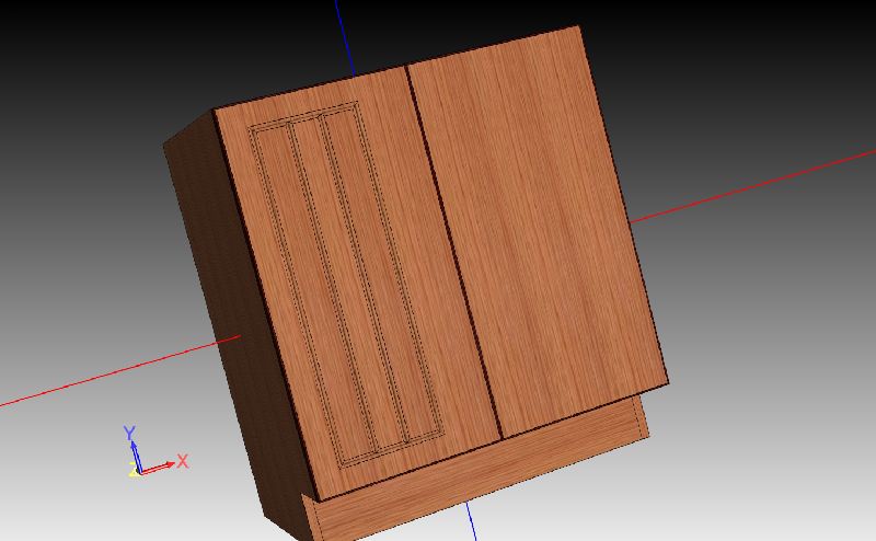

Bryan, You can take a Slab Door to the PE. There you can create tool paths to get the look your after. Here is a quick sample that I did in a few minutes.
tool paths.jpg (47.07 KiB) Viewed 36325 times

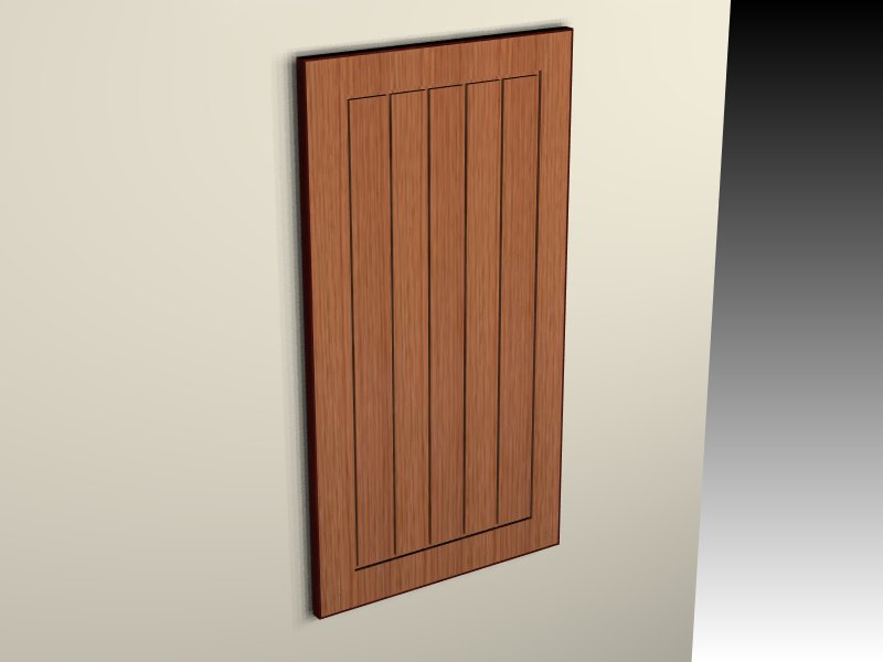

When I need a door like that
I make the in door maker start with a slab then I bring in a DXF that I make in a Cad program.
or you can make it in e-cabinets
Rick you beat me to it
Door 17 x 32.jpg (33.93 KiB) Viewed 36323 times

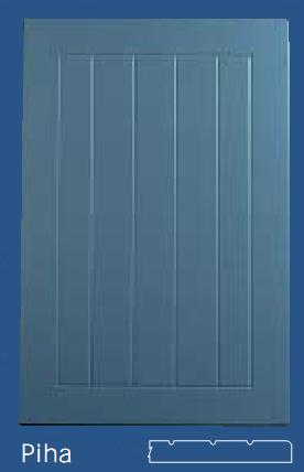

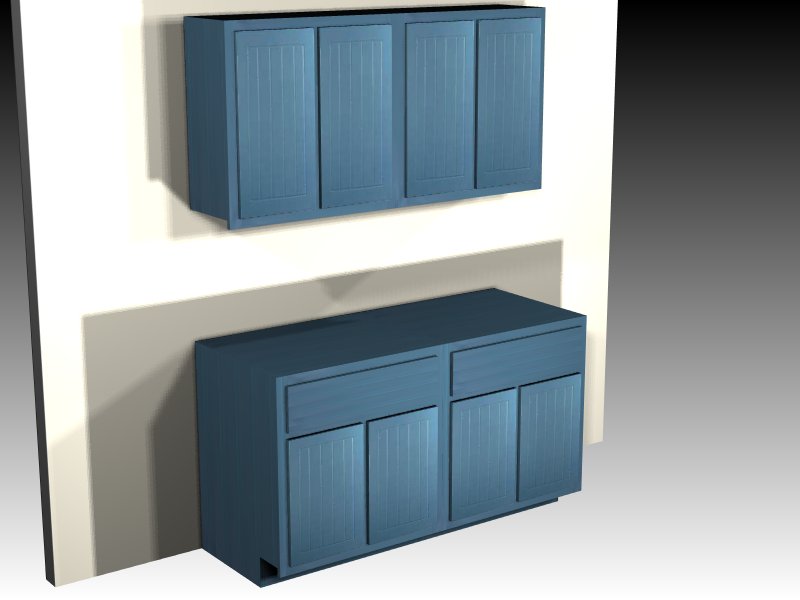

I put your picture on a Display Cube make sure you check on (Stretch) that way it will fit the panel
I made a sheet good as Piha .75 x 48 x 96
I made a borad stock as Piha
Piha Cabinets.jpg (41.34 KiB) Viewed 36310 times

Thats quite effective George!
