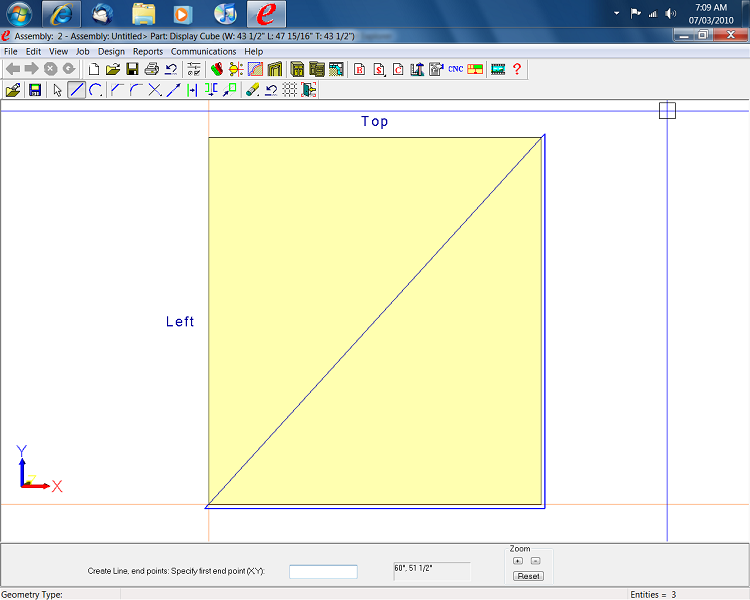

With your cube in the Contour Editor, draw a connected line around half the cube bisecting it corner to corner. Then take it back to the Part Editor, right click and select Cut/Pocket using closed contour, select the line , cut through.

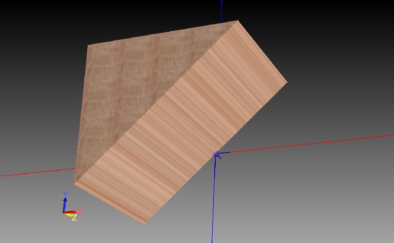

Re: Triangular sided "cube"
Create the cube differently. I created this cube as 43.5x48x43.5. If you create it 48x43.5x43.5 then the longer face will show in a different position.
Yes Nat. In the Part Editor you can only access the front and back face.

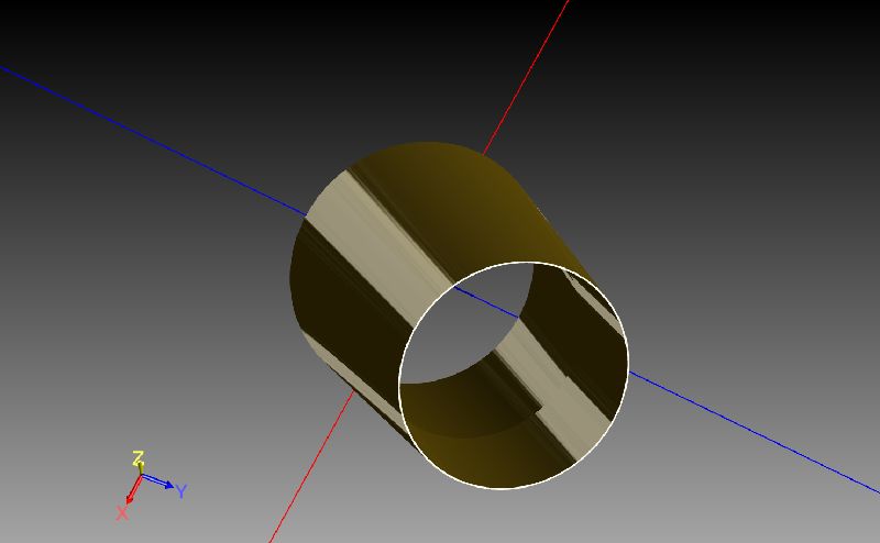

Here is an example of a cube using a tool path and tall angled cutter.
Dennis Englert
Post by Dennis Englert »
If I understand your reason for wanting to rotate the half cube, you can probably get that cut you're looking for by creating a profile shape that is a 45 degree undercut the height and depth that you need. The apply the profile to one of the visible edges on the top surface.
